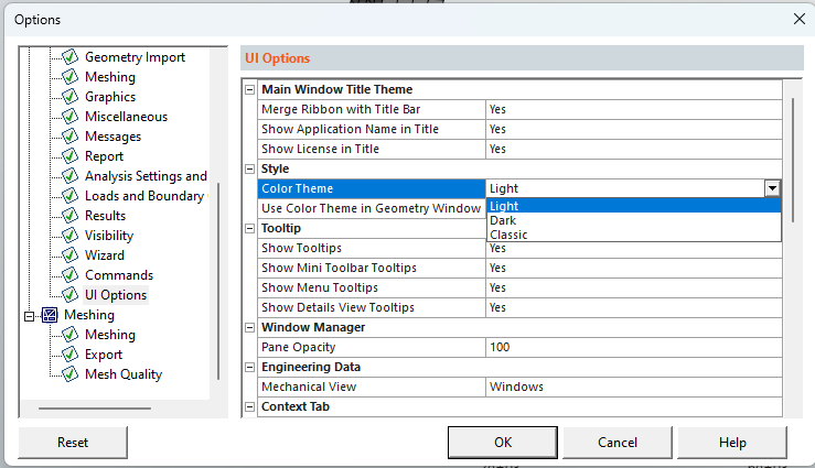

      Do you want user interface to be updated for the Workbench or Mechanical?
      To modify the Mechanical UI, you can follow below steps:
      1. Open ANSYS Mechanical.
      2. Navigate to File > Options > Mechanical > UI Options > Style.
      3. Set the Color Theme to Light.
      4. Click on OK to apply the changes.
      Refer below snap to change Mechanical UI Setting.

      Hi rkoomul,
      The steps described by @niteen will change the meshing UI as well.
    • rkoomul
      Modifying the UI theme in Mechanical automatically changed the UI theme in Meshing as well.
      Thank you very much for the help.
