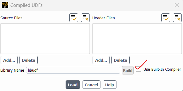

SubscriberWhile running UDF - I am getting warnings that fopen, fscanf are deprecated and use fopen_s, f_scanf_s_l for safety, I am unable to find documentation for same.Â
SOme of the warnings like - '_vsprintf_l' is deprecated: This function or variable may be unsafe. Consider using _vsprintf_s_l instead. the same is not used in the code anywhere, can anyone help me out to figure out how to sort this along with documentation link for above ?Â
Thanks in advance

Details on the I/O functions can be found here: A.13.3. Standard I/O Functions A.13. C Library Functions
Have you tried compiling using in-built clang compiler?

SubscriberHi,Â
Can you guide me on using/knowing the clang compiler ? That would be most helpful.
