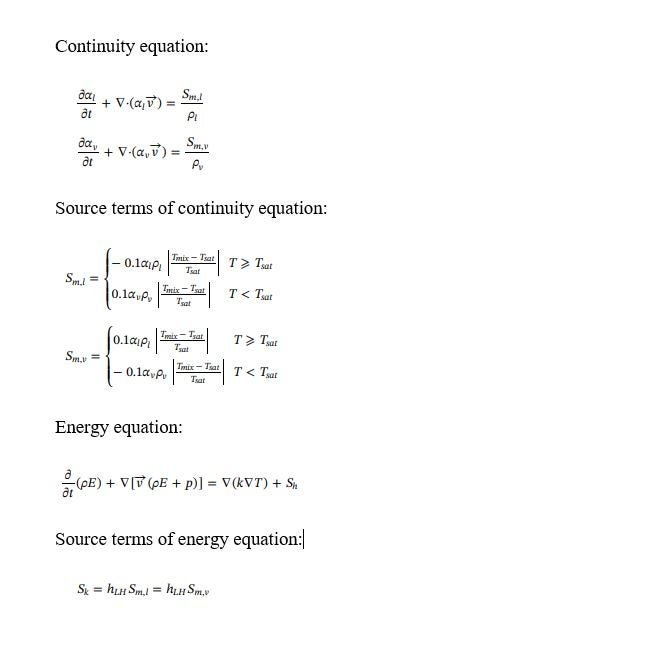

SubscriberThanks Rob, now I'm able run simulations. Actually in my governing equations there are mass and energy source terms. For which I have written Udf's using DEFINE_SOURCE macro for both the mass and energy transfer source terms. And I'm using VOF (Volume of fluid) method. But I'm unable to see any phase interactions between the vapor and liquid.
My question is only DEFINE_SOURCE macro is sufficient or else do I need any additional Udf's like creating neighbor cell and liquid volume, etc,.
These are my governing equations:
February 7, 2022 at 4:53 pmRob
Forum ModeratorThe VOF model should take care of the phase interaction. What, and where are you adding the source terms?
February 7, 2022 at 5:35 pmAmine Ben Hadj Ali
Ansys EmployeeVOF model assumes that the sum of phase interaction when it comes to momentum is zero on mixture level (neglecting surface tension effects now) no mass on mixture level and just energy source term to account for latent heat times mdot plus sensitive part as the code is using Tref = 298 K and SS is not taken into account. To avoid all of this: use a dedicated phase change UDF macro where you don't need to take care about all secondary fluxes

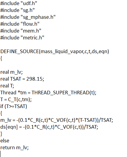

SubscriberHi Rob, I have written Udf's of mass source terms for both liquid and vapor phases separately and adding them to their respective phases under cell zone conditions. Even, wrote Udf for energy source term and added it to the mixture phase in cell zone conditions. Below I'm posting my Udf for liquid mass source term, please check is it correct.

February 8, 2022 at 11:15 amRob
Forum ModeratorLooking at the code I won't comment on the amount of source, but the ELSE part of the statement doesn't look to do anything useful. Note, for VOF you need to be very careful that you're adding enough phase into the system as it's not designed to track cells with "some" other phase, VOF is intended to track the free surface.
