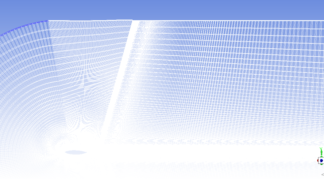

      We are trying to model a fish swimming with undulating motion. Does anyone has a UDF example that we can start with? Thanks.

      Thank you for your quick replies. What I need to do is put the fish in wavy motion. Therefore, I need a UDF so I can put the fish through some lateral or vertical displacement as a function of time. I am not sure what the UDF should look like or more specifically, what parameters it should pass to Fluent. I will provide a picture for more clarity.
      Kamran
      (I posted this earlier but somehow that post is gone now).
    • kfouladi
      Here is a picture
      Thanks. As Jeremy says you'll need the DEFINE_GRID_MOTION macro to define change in shape of the object. There's an example in the UDF manual, and as an ASC you should be able to access the Customer Portal for additional resources: I'd suggest looking at the UDF and Moving Mesh materials.
