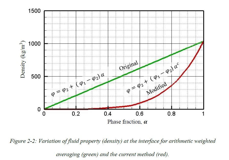

I want to write a UDF to calculate the fluid properties (density & viscosity) through a modified exponential equation as attached in the file and not use the regular linear interpolation at the interface in case of VOF method.

SubscribernI know that rho and mu are based on mass fraction for mixtures. But my purpose here is to change the way in which the properties are being determined at the interface. I see that the properties at the interface depend on the phase fraction as below, which is what I'm trying to replicate using a UDF.nPlease correct me if I'm wrong in this aspect.n*SCREENSHOT REMOVED by DrAmine*nApril 19, 2021 at 8:51 amRob
Forum ModeratorIf it works without the UDF and fails with the UDF then I'd be looking at what the UDF is doing. I'd also see about hooking the UDF up to calculate the values only, and not apply them in the working VOF case. How do the flow and properties differ from the ones Fluent is using? nApril 19, 2021 at 1:06 pmVenky_94
SubscriberI'm definitely sure the issue is with the UDF somewhere, but I'm unable to quite put a finger on what exactly. Below is a picture of the expected variation in properties as compared to Fluent's native method. The UDF I've written right now is the original implementation of FLUENT's VOF, so I'm expecting an arithmetic weighted average as the green line below. n

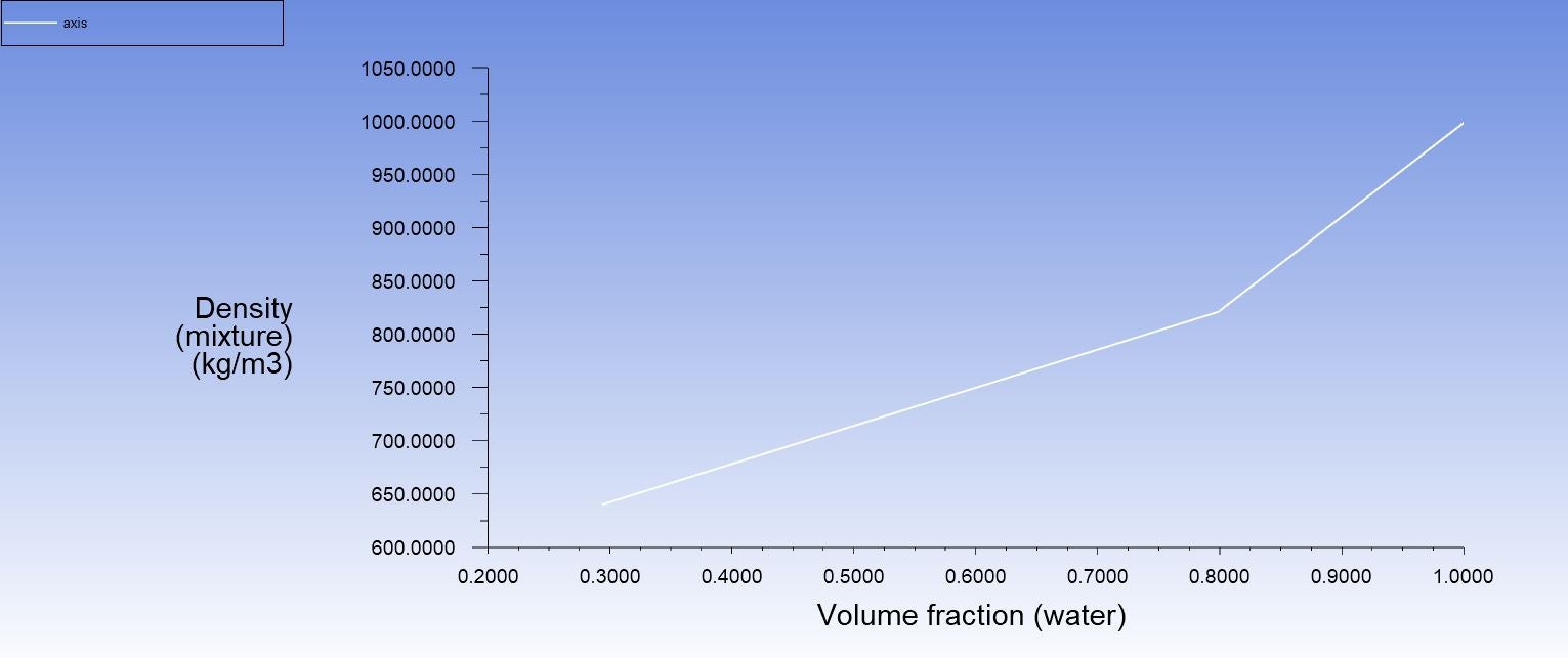

And here is an image of the property I'm obtaining through my UDF.n
I'll try maybe storing the property values in a file along with the phase fraction to see if I can get any information on it. But any other suggestions would be great.nn

SubscriberHi Array ,nThe purpose is to better study the interfacial property in highly viscous fluids. I'm only using water to begin with. The significance and effectiveness of the function in determining interface property is best explained in the first picture involving a comparison. And to answer the question, yes, I'm trying to modify the way density and viscosity at the interface are determined in VOF solver.nAnd for the second part of your answer, if you could take a look at my below response, I am using the same function for both phases (water and air). I've shared the functions I'm using for density and viscosity. Any suggestions on how to avoid the issues I'm facing?n ,nThe purpose is to better study the interfacial property in highly viscous fluids. I'm only using water to begin with. The significance and effectiveness of the function in determining interface property is best explained in the first picture involving a comparison. And to answer the question, yes, I'm trying to modify the way density and viscosity at the interface are determined in VOF solver.nAnd for the second part of your answer, if you could take a look at my below response, I am using the same function for both phases (water and air). I've shared the functions I'm using for density and viscosity. Any suggestions on how to avoid the issues I'm facing?nnApril 19, 2021 at 10:58 pmVenky_94
SubscriberHey Array ,nI tried out suggestion and created a Adjust UDF to store the values of density and viscosity along with the phase fraction of both the native method and the values calculated by my UDF function in separate files and compared them.nThe values of density are exactly the same in both cases for the same value of phase fraction, and the viscosity is almost similar but varies by around +/- 0.0005%, which is too small to make a difference I think. So I'm not sure exactly why this approach isn't working. Please suggest.nApril 20, 2021 at 9:43 amDrAmine
Ansys EmployeeAre you plotting node values along the axis? What is your resolution along the line?nApril 21, 2021 at 2:57 pmVenky_94
SubscriberI did not need to plot the values. I obtained the density and viscosity values for all cells with phase fraction between 0 & 1. And since there were only 40 or so cells, I directly compared the values. nViewing 17 reply threads- The topic ‘UDF for fluid property determination in VOF’ is closed to new replies.
