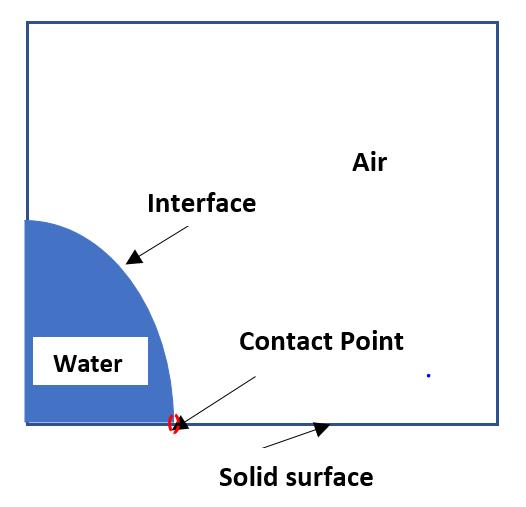

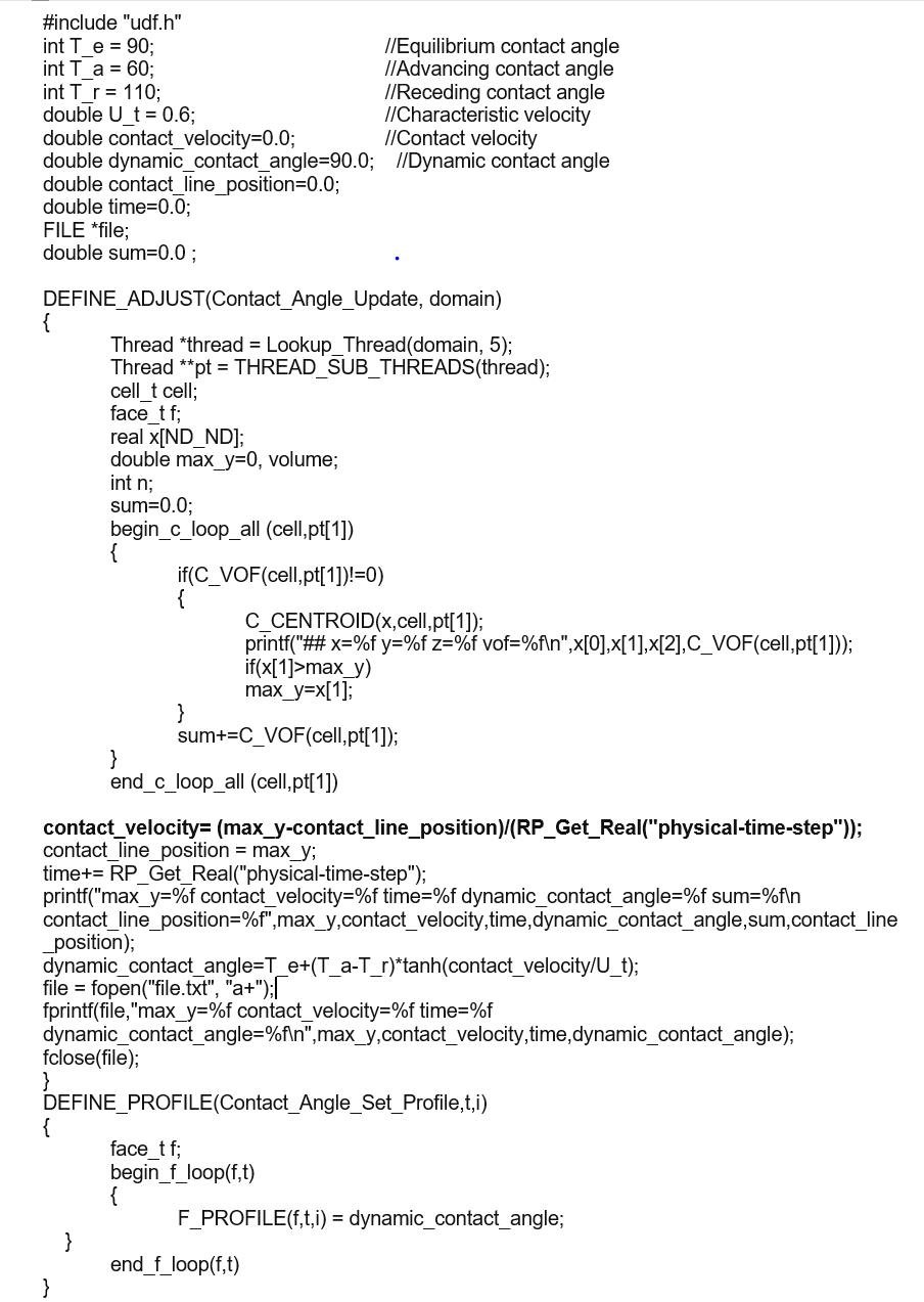

I have been working to set dynamic contact angle at a boundary condition using UDF for a droplet impingement problem. It is a 2D axi-symmetric and Volume of Fluid model with air and water.
In my case, the dynamic contact angle will change like the below;
θ_d (t)=θ_e+(θ_a-θ_r)*tanh((U_c (t)/U_t )
U_c(t) is the component of the interface velocity parallel to the substrate at the contact point. The other parameters are constant. I couldn’t figure out to get the dynamic contact velocity.
I hope someone could help me on this issue. Thanks for your valuable time and help. The UDF code is as follows;

Ansys EmployeeYou want to provide advancing and receding angle for your interface: correct? Then you need to use DEFINE_PROFILE to change the contact angle. Offcourse you can calculate everything in a ADJUST assign the results in UDMI then use that UDMI value in the profile.
March 15, 2019 at 10:13 am
ahmetgultekin
SubscriberYes I want to change the contact angle with constant advancing, receding angle and time-dependent interface velocity. My main problem, I couldn't get the interface velocity Â

ahmetgultekin
SubscriberThanks rwoolhou for your comment
I am going to explain my problem more clearly.I have a single droplet and I have an expression for dynamic contact angle which is a function of contact line velocity. Also, I attached a basic geometry to show the contact line.
Can anyone help me to uderstand that how the velocity of contact point (at three phase contact line) can be evaluated and used as a variable in Ansys ? By the way, the contact point moves when there will be change in the contact angle.

DrAmine
Ansys EmployeeYou might have a look into: VOF simulations of the contact angle dynamics during the drop spreading: standard models and a new wetting force model
