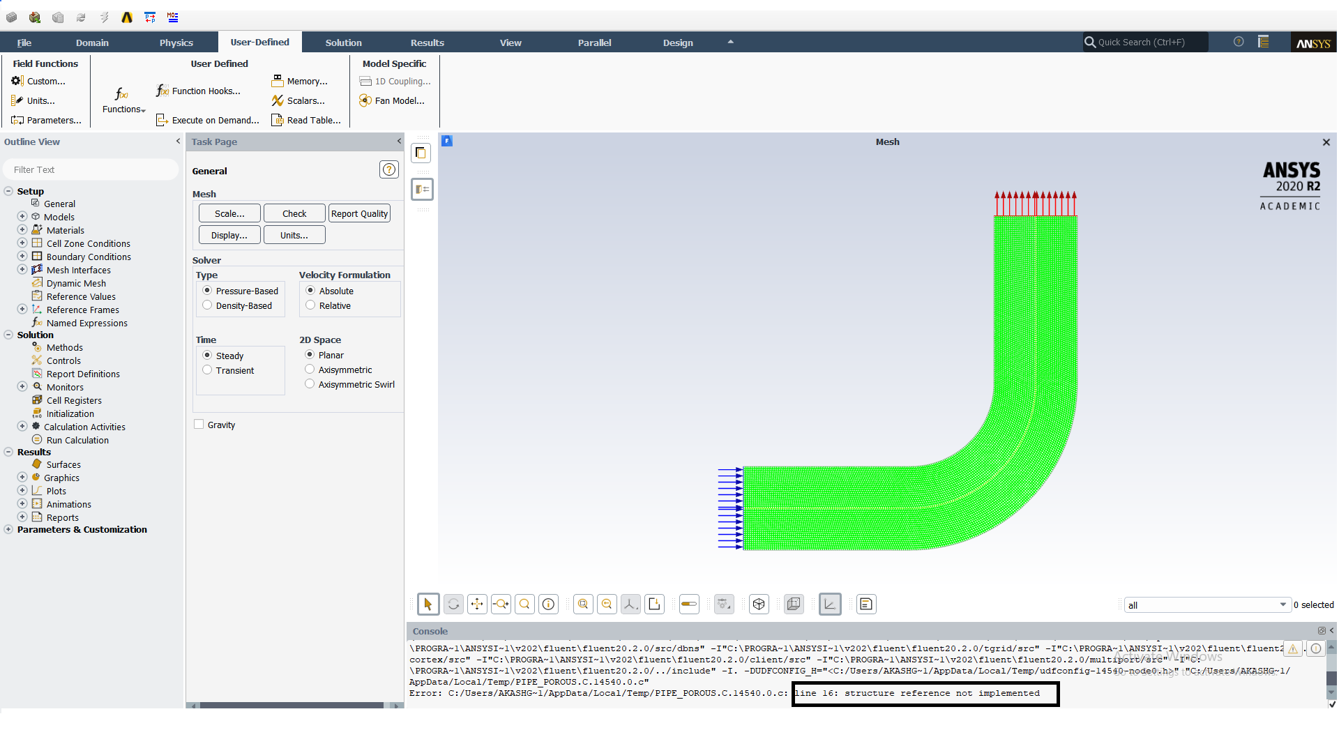

      My problem is that I am not able to compile this code and its showing error in the line shown below.
      if (FLUID_THREAD_P(t) && THREAD_VAR(t).fluid.porous)
      As per the problem shown in the tutorial, reaction happens only in the porous zone and above line which is showing error makes sure that its taking porous domain only. But I am not getting why its showing error in this line.

      Its showing that "structure reference not implemented". (for "interpreted" option)

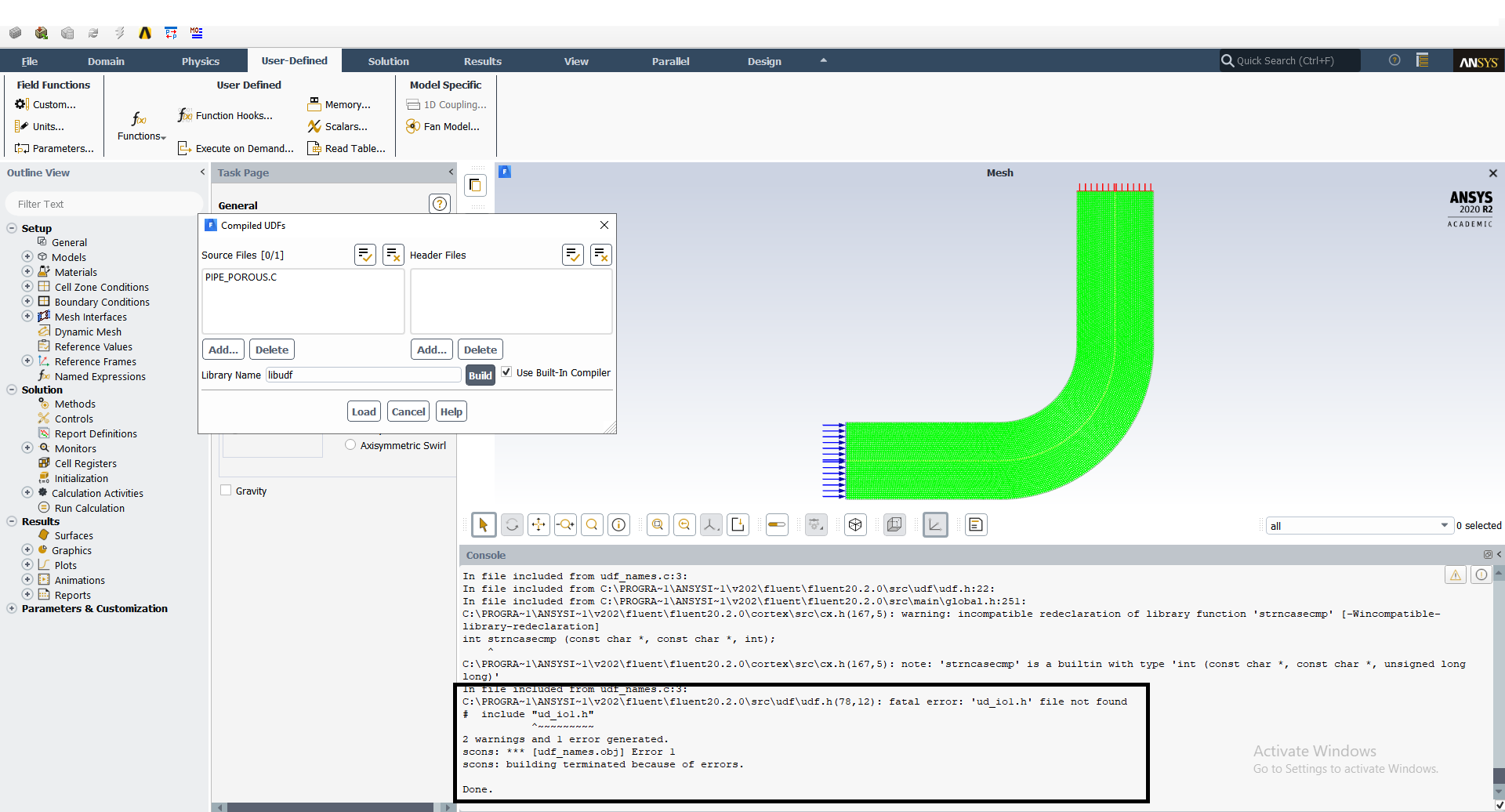

      After that I tried to "compile" it but its showing below mentioned error
      and when I used "built in compiler" , its showing that ud._iol.h file not found.

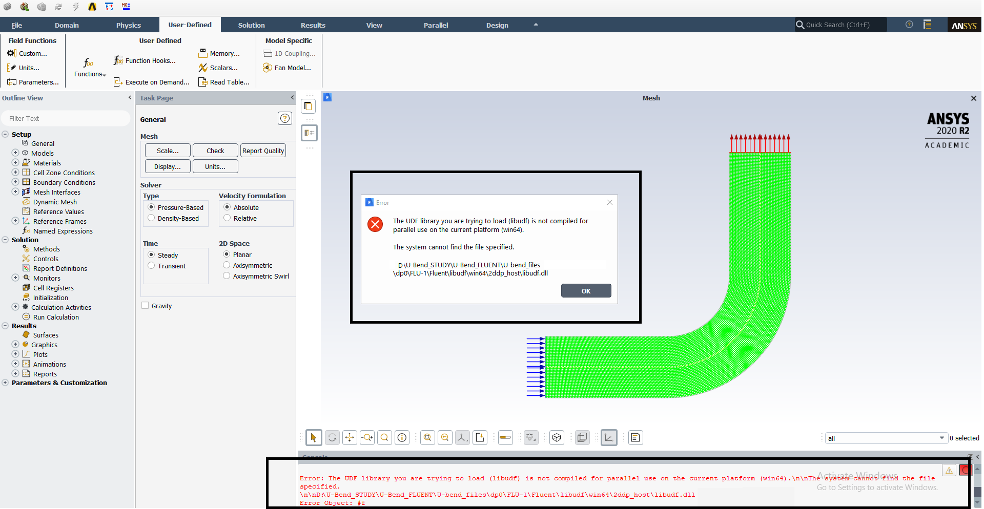

      Hi Everyone, Problem is resolved now. There are two problems.
      1) It reads only ".c" File not ".C" file.
      2) I am able to compile the UDF with command prompt in my windows system. But unable to do it directly.
