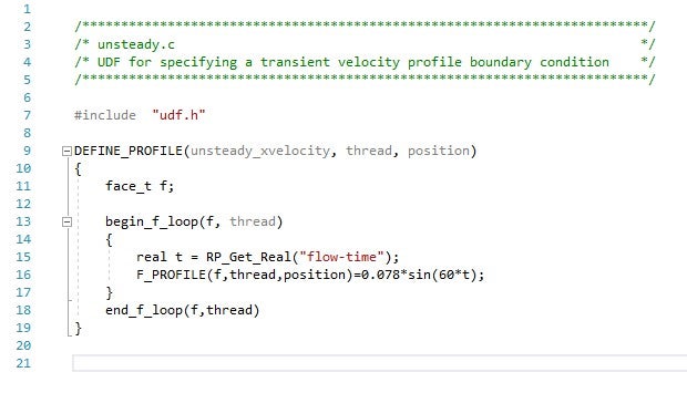

      I have been trying to solve the error: “The UDF library you are trying to load (libudf) is not complied for parallel use on the current platform (win64)” when I am planning to insert my .c file so as to set UDF for inlet velocity profile (human breathing sinesoidal pattern).

      Below is my .c code for setting variable velocity inlet of human breathing patterns (inhaling and exhaling):

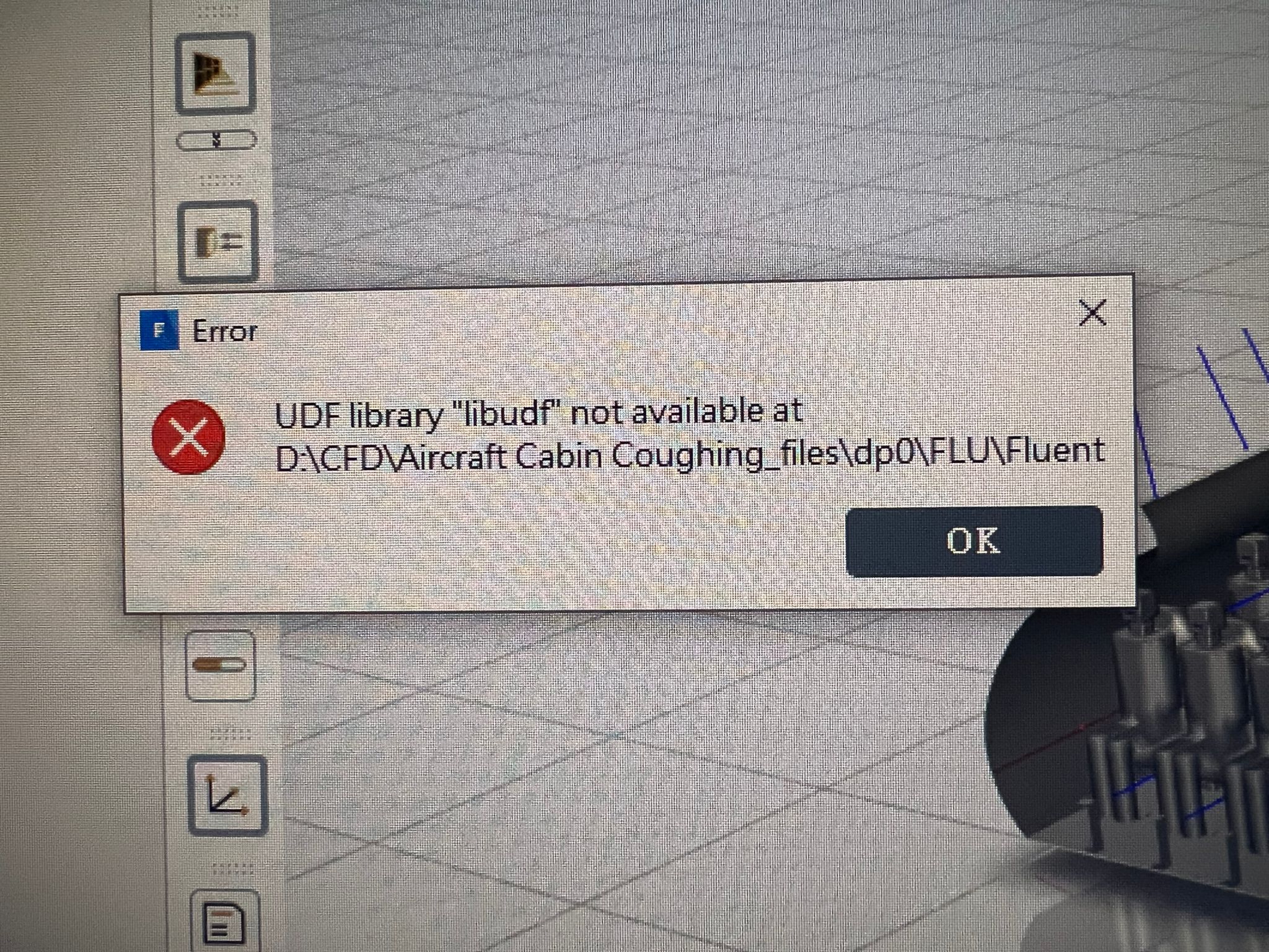

      Below is the error window popped up after loading the .c file:
      DESKTOP-3DT4CDJ: Opening library "C:\Test\libudf"...
      Error at host: The UDF library you are trying to load (libudf) is not compiled for parallel use on the current platform (win64).
      The system cannot find the file specified.
      C:\Test\libudf\win64\3ddp_host\libudf.dll
      Error at Node 9: The UDF library you are trying to load (libudf) is not compiled for parallel use on the current platform (win64).
      C:\Test\libudf\win64\3ddp_node\libudf.dll
      Error at Node 0: The UDF library you are trying to load (libudf) is not compiled for parallel use on the current platform (win64).
      Error at Node 1: The UDF library you are trying to load (libudf) is not compiled for parallel use on the current platform (win64).
      Error at Node 2: The UDF library you are trying to load (libudf) is not compiled for parallel use on the current platform (win64).
      Error at Node 3: The UDF library you are trying to load (libudf) is not compiled for parallel use on the current platform (win64).
      Error at Node 4: The UDF library you are trying to load (libudf) is not compiled for parallel use on the current platform (win64).
      Error at Node 5: The UDF library you are trying to load (libudf) is not compiled for parallel use on the current platform (win64).
      Error at Node 6: The UDF library you are trying to load (libudf) is not compiled for parallel use on the current platform (win64).
      Error at Node 7: The UDF library you are trying to load (libudf) is not compiled for parallel use on the current platform (win64).
      Error at Node 8: The UDF library you are trying to load (libudf) is not compiled for parallel use on the current platform (win64).
      Error at Node 10: The UDF library you are trying to load (libudf) is not compiled for parallel use on the current platform (win64).
      Error at Node 11: The UDF library you are trying to load (libudf) is not compiled for parallel use on the current platform (win64).
      Error at Node 12: The UDF library you are trying to load (libudf) is not compiled for parallel use on the current platform (win64).
      Error at Node 13: The UDF library you are trying to load (libudf) is not compiled for parallel use on the current platform (win64).
      Error at Node 14: The UDF library you are trying to load (libudf) is not compiled for parallel use on the current platform (win64).
      Error at Node 15: The UDF library you are trying to load (libudf) is not compiled for parallel use on the current platform (win64).
      Error at Node 16: The UDF library you are trying to load (libudf) is not compiled for parallel use on the current platform (win64).
      Error at Node 17: The UDF library you are trying to load (libudf) is not compiled for parallel use on the current platform (win64).
      Error at Node 18: The UDF library you are trying to load (libudf) is not compiled for parallel use on the current platform (win64).
      Error at Node 19: The UDF library you are trying to load (libudf) is not compiled for parallel use on the current platform (win64).
      Error: The UDF library you are trying to load (libudf) is not compiled for parallel use on the current platform (win64).\n\nThe system cannot find the file specified.
      \n\nC:\Test\libudf\win64\3ddp_host\libudf.dll
      Error Object: #f
