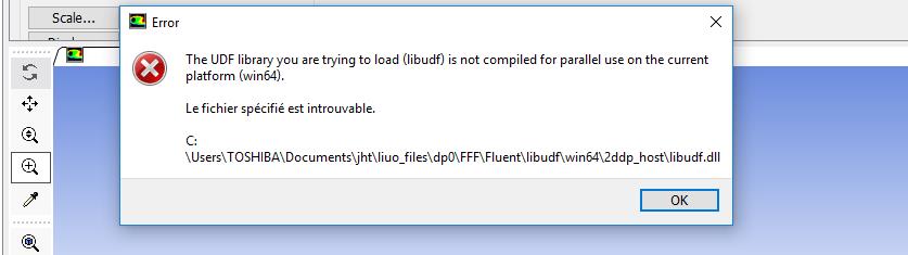

      Hello everyone!

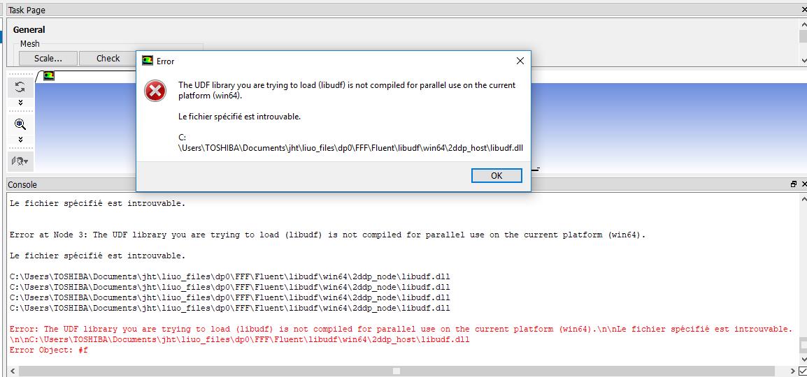

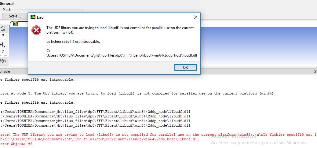

      when I want to use UDF for as an input condition of a turbulent flow with a model K-w SST  I received this message.
      In your opinion how can I solve this problem ?
      Error: The UDF library you are trying to load (C:UsersTOSHIBADocumentsmoiliuo_filesdp0FFFFluentlibudf) is not compiled for 2ddp on the current platform (win64).nnLe chemin d?accès spécifié est introuvable.
      nnC:UsersTOSHIBADocumentsmoiliuo_filesdp0FFFFluentC:UsersTOSHIBADocumentsmoiliuo_filesdp0FFFFluentlibudfwin642ddplibudf.dll
      Error Object: #f
      Best regards,
      SER
    • Amine Ben Hadj Ali
      Do you have a compiler installed? If Yes try to compile at first from Standalone Fluent.
      If you have already compiled the UDF and loaded it then please unload first, compile it again and try again.

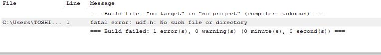

    • abd fs
      Dear Amine,

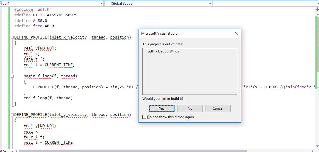

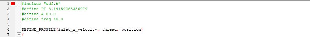

      I use code Block ,this is the message I received
      Someone can help me? With some tips, comments?
      Best regrads,
      SERRARE
      30/5000
      There are a few threads covering compilers on here, please have a look in
      /forum/forums/topic/ansys-19-0-visual-studio-intel-parallel-studio-xe-version-required-for-upfs/
      I am not sure if codeblock will work and it is not supported
      Or try to interpret in Fluent.

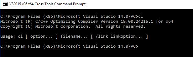

      Thank you, my system consists of the following:
      - Microsoft Windows 10 x64
      - ANSYS Fluent 17.0 x64
      - Microsoft Visual Studio express_2015_for_windows_desktop_x86_x64_web_installer_6846484
      I tested VS and received :
      but I don't know is it good or bad.
      Best regards,
      SER

      Start Fluent from the VS command prompt and try compiling.

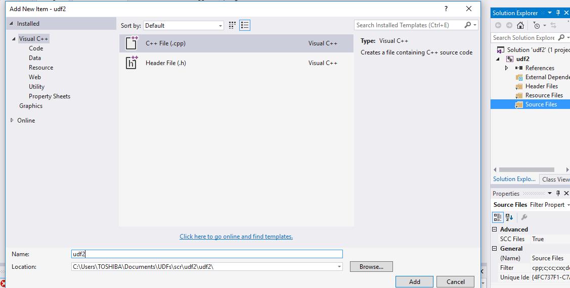

    • abd fs
      Dear friends,
      I'm using :
      Windows 10 64bit
      ANSYS17.0  64bit
      en_visual_studio_community_2015_with_update_3_x86_x64_web_installer_8922963
      en_visual_studio_2015_sdk_x86_x64_6846633

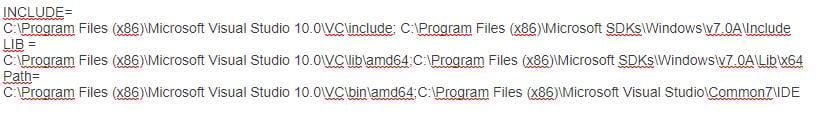

      environment variables:
      include
      C:Program Files (x86)Microsoft Visual Studio 14.0VCinclude ; C:Program Files (x86)Microsoft SDKsWindowsv7.0A
      lib
      C:Program Files (x86)Microsoft Visual Studio 14.0VClibamd64 ; C:Program Files (x86)Microsoft SDKsWindowslibx64
      Path
      C:Program Files (x86)Microsoft Visual Studio 14.0VCbinamd64 ; C:Program Files (x86)Microsoft Visual Studio 14.0Common7IDE ; C:Program FilesANSYS Incv170fluentntbinwin64
      but unfortunately the problem remained the same
      are these environments correct?

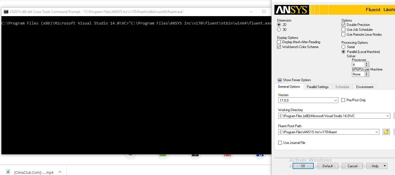

      Once again start Fluent from x86_64 command prompt of VS and try to compile the UDF there (in the ANSYS Fluent started from the x_86_64 prompt).
    • abd fs
      Dear Amine,
      Thank you for your answer, but I have already followed your advisor(start Fluent from x86_64 command prompt) but the error remains the same.
      if you can, is the environment that I have already indicated correct?
      Best regards,
      SER
      If you still have problems running from the x86_64 then it means that you still have compiler issues. Make a clear uninstall and install once again with explicit admin rights.  For VS 2015 you do not require to install the SDK.
      VS will input what it requires into lib, include and path. If compilation is successful then you just append lib, path and include from the CMD of x86_64 into the lib, include and path from windows env variables under control panel.

      The worakround is to type env from x86_64 CMD of VS and then append the include, lib and path here to the include, lib and path in the control panel env. variables. You need to check if the latter do contain similar things as this might lead to inconsistency.
      That is why check at first what do the env variables from control panel contain.

      Did you start FLUENT from the VS prompt? I cant compile the UDF because I received this message
      Best regards,
      SE

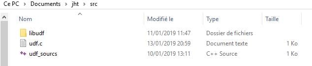

    • abd fs
      ok
    • abd fs
      The library got created after succful compilation of my UDF which is not the case for you. Please then stick to the second part of my last reply:
      1/Clean-up everything: uninstall all VS distribution you have.
      2/Run as admin VS installation
      3/Start Fluent from VS x86_64 prompt. Here Fluent would compile.
      4/Step 3 can be avoided by just appending the output of include, path and lib variables from "env" in the VS prompt into the control panel env. variables.
      Your Windows wants to tell you that it needs to be activated.

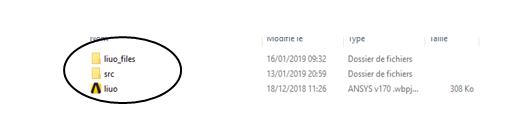

    • abd fs

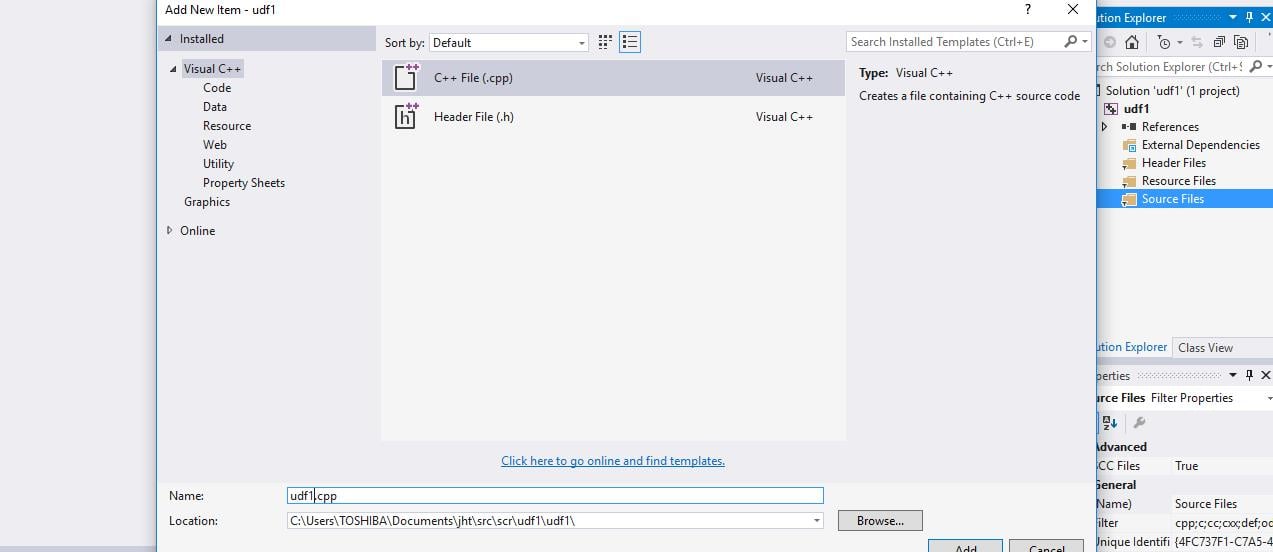

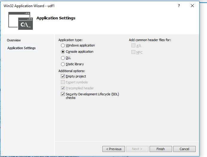

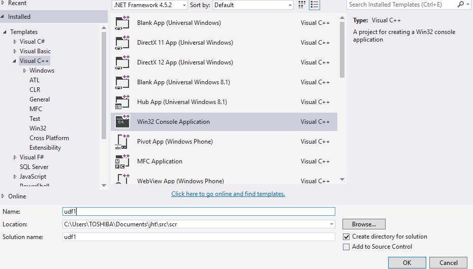

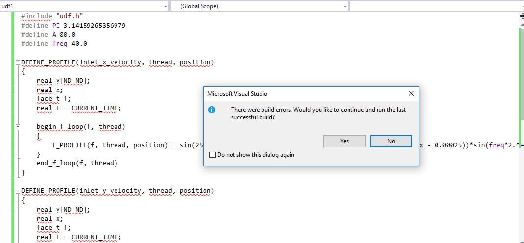

      Dear Amine,
      I did all the steps, as you asked me to do,but I received the same message !
      That's what I do :
      the three files in the same folder, with SRC contains the UDF file
      Environment
      include  -   C:Program Files (x86)Microsoft Visual Studio 14.0VCinclude;C:Program Files (x86)Microsoft SDKsWindowsv7.1AInclude; lib -  C:Program Files (x86)Microsoft Visual Studio 14.0VClibamd64;C:Program Files (x86)Microsoft SDKsWindowsv7.1ALibx64; path - C:Program Files (x86)Microsoft Visual Studio 14.0Common7Tools;C:Program Files (x86)Microsoft Visual Studio 14.0VCbin;C:Program FilesANSYS Incv170fluentntbinwin64 What can I do more ? please
      Best regards,

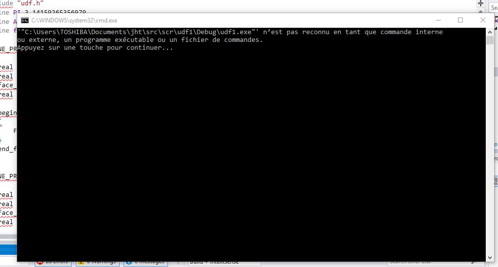

      SE

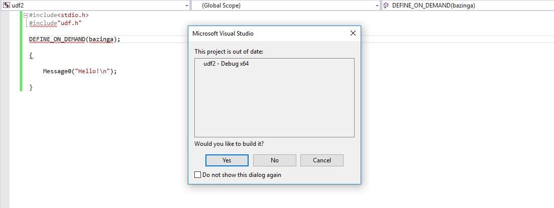

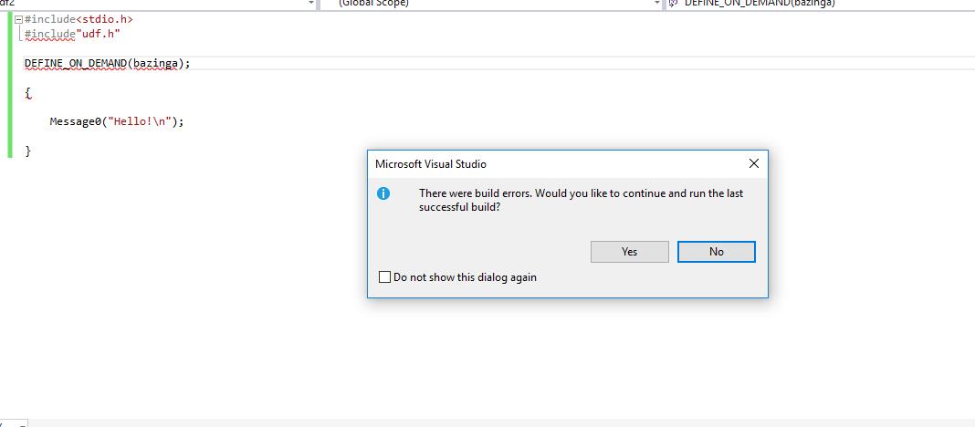

      Please start Fluent from the VS prompt and just compile:
      DEFINE_ON_DEMAND(bazinga)
      Message0("Hello!n);
    • abd fs

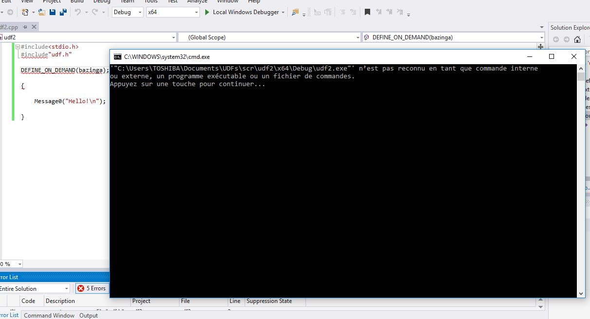

      Dear Amine,
      Thank you,but I received the same message .
      That's what I do :
      Best regards,
      SE

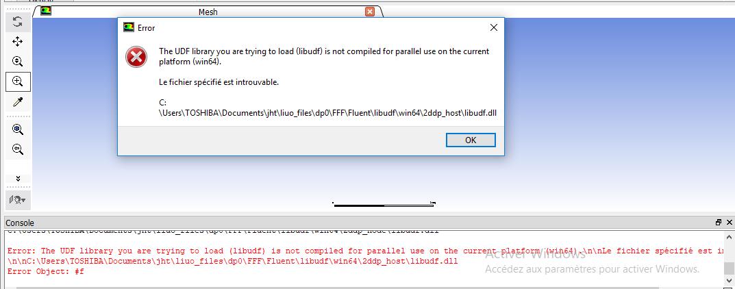

    • abd fs
      Dear Amine ,
      After compiling VSx86x64, I received this message
      what does this message mean
      Best regards,
      SE
      The Load error either means it's not compiled or the file doesn't exist. If you scroll up is there an error message with "nmake" in it?

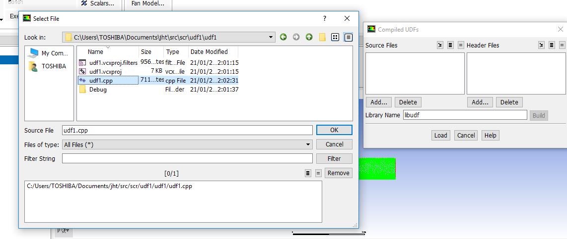

    • abd fs
      Dear rwoolhou,
      Thanks for your attention and quick reply, I have never received an error related to nmake.
      Best regards,
      SE
      Please can you post all of that message? There are two parts to compiling, the first relates to you code (is it correct) and the second to the compiler (have you installed it): the load error means one or both have failed but we're struggling to figure out what you've (not) done to be able to help.
    • abd fs
      Dear rwoolhou,
      I am sending you all the steps and pictures.
      Best regards,
      SE
      What happens if you read the udf1.c file into the Fluent compiler process?
    • abd fs
      Dear rwoolhou,
      Best regards,
      SE
      So now you are directly trying compiling the *.c file? Have you activated your Windows?
    • abd fs
      Dear Amine,
      Yes
      Best regards,
      SE
      Let me summarize all points:
      1/Windows i activated: Yes
      2/Installed everything and compiling from VS prompt does not work
      We cannot help more here. Please recheck every single step, cleanup every single VS distribution on your computer, check the env. variables are remove old content from there (pointing to some VS or SDK things..). Re-Install with explicit admin rights and try again.
      That is the procedure which would work.
      By the way I recommend to update your ANSYS version and use the developer tools 2017 which are enough to get started
