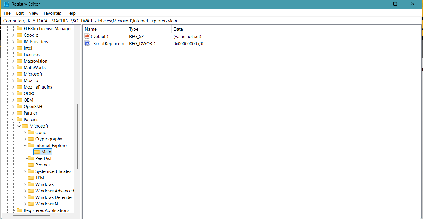

    • NVN NAMMA
      I followed the steps for modifying a registry key as is, but it is still showing the same error.
      iIs there anything wrong in the steps followed. And my windows is Windows 11 Pro (
      Version 10.0.26100 Build 26100) and not sure about the following two steps are done right or not! (
      4. Name the new value JScriptReplacement.
      5. Set the value of JScriptReplacement to 0.
    • Mike Pettit
      That looks ok to me, I think. Did you also restart the computer?
      Mike
      • NVN NAMMA
        yes, Mike, I restarted the system also. Then what would have gone wrong?
        1. Launch regedit.
        2. Navigate to: HKEY_LOCAL_MACHINE\SOFTWARE\Policies\Microsoft\Internet Explorer\Main
          (Create the folder Keys for Internet Explorer and Main if they do not exist)
        3. Right-click the Main key and select New | DWORD (32-bit) Value.   ; Is this always 32-bit?
        6. Reboot the computer.
        Users can directly modify the registry key in either HKEY_LOCAL_MACHINE (as shown above) or HKEY_CURRENT_USER.
        • Mike Pettit
          I'm not sure why this would not have worked. Are you working on a university machine? Maybe there is an IT policy that prevents the registry from being modified?

    • NVN NAMMA
      Thanks, Mike for the detailed instructions. Yeah, I am using my university system, while saving the files it asked for admin permission and I couldn’t save it. I will meet the system admin and see if is there any way out.
      I contacted my system admin. We also changed the registry settings in the current user. Now it's working Fine. Thank you so much..🙏
