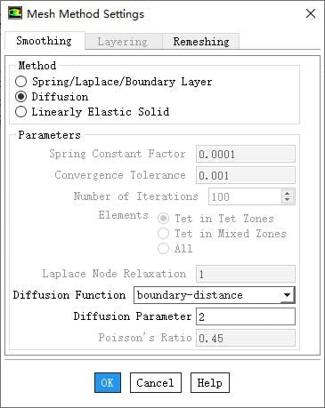

      This is what want to simulate but it always has same error. I tired to reduce the time step, change the fluid mesh into tetrahedrons method, change the dynamic mesh method with smoothing and remeshing  methods, inside of the smoothing method, I changed it from Spring/Laplace/Boundary Layer in to Diffusion with parameter 2. But stil does not work. So I am seeking for help that anyone could help me to see where the setting is wrong. I uploaded my workbench file.

      The setup of fluent, smoothing and remeshing are as shown in down below.

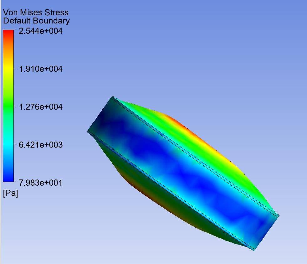

      This is a result from one run although it ends with same error: Negative volume detected.
      Besides the error, the deformation of membrane is not right as well. I believe it suppose to be that the actuator membrane is stuck in and the other membrane is swelling. Hence, is there any possible setup error in the simulation?

      Your answer seems to be pointing to the fact that the quality of your initial mesh might be poor. It is not necessary to have large element sizes. However, it is very important to have a good starting mesh. The reason for the negative elements is because your quality is deteriorating and at some point in your simulation, Fluent ends up with a mesh that is locally skewed.
      Please identify the regions with poor quality, improve them at the beginning. Please test your simulation with the improved mesh and let us know.
