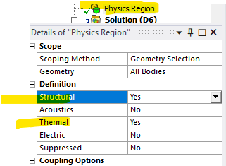

SubscriberThanks for your help. It seems 'coupled field transient' analysis can solve coupled problem. But I see that it also have the dynamic effect as well:
However I just want to have only coupled theromoelastic analysis without activating the dynamic terms. Is this a way to turn off the dynamic term in WB?
Thanks
February 19, 2024 at 4:29 pm
Govindan Nagappan
Ansys EmployeeYou can set “time integration” to “off” in details of analysis settings. Test it and see if it helps.
