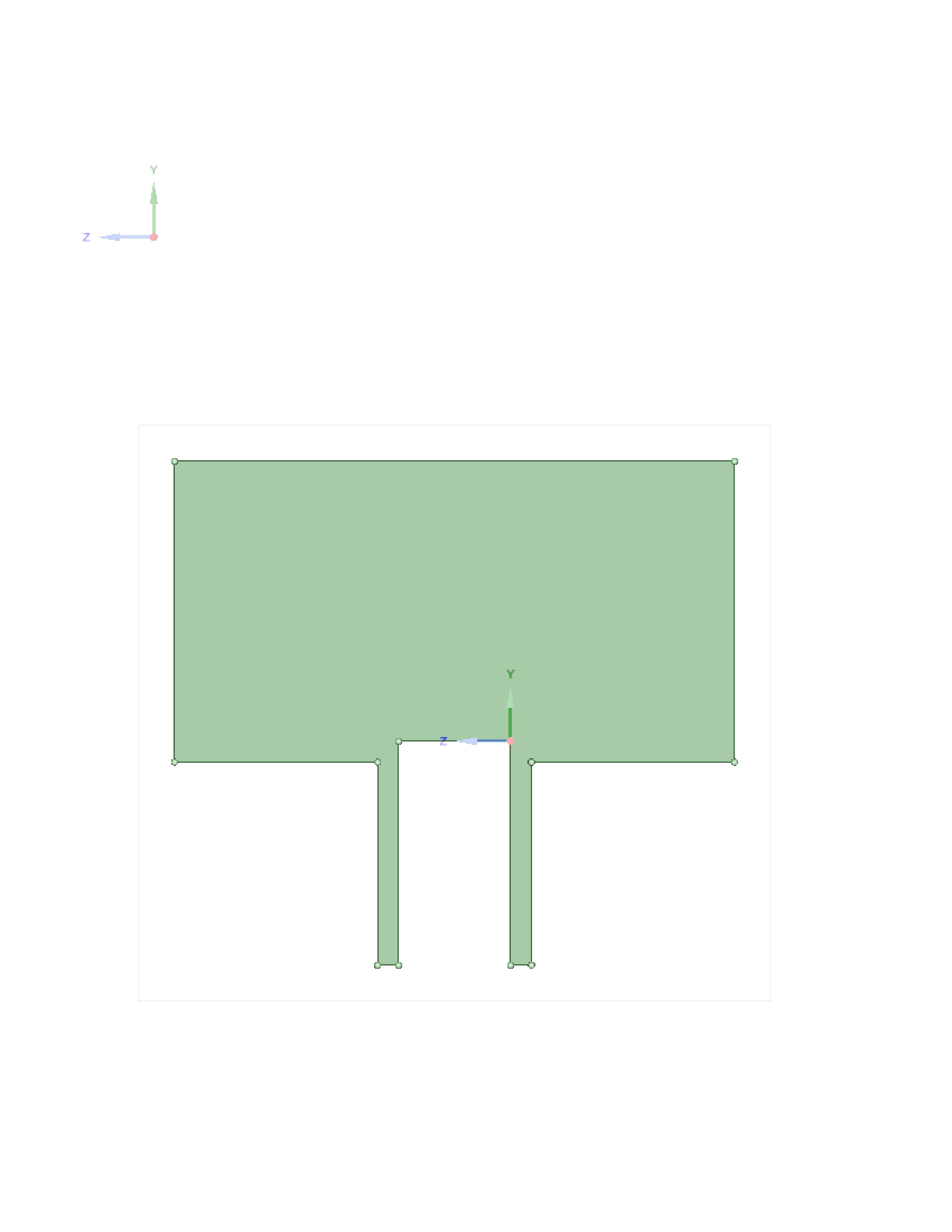

Trying to draw to steel angles with a block of wood on the top side of the angles. For some reason when i use Pull, the top side or surface of the angle and the wood block becomes one solid. I'd like the wood block to be a separate solid from angles so i can assign them different materials. I am not sure what i am doing wrong. Any help would be appreciated!

Ansys EmployeeSelect face and use ctrl + c and ctrl + p. This will copy the face.Â
Now use pull for this new face. While using Pull, please select 'No Merge' option.Â
Hope this helps.Â

Ansys EmployeeThe No Merge option, as correctly shown by Keyur, is exactly for making geometry modifications to single parts (like the block you are showing) without the final step of any geometry change, which is an all-over, body-wise clean-up. In your example, it does not fee like a clean-up, because your design intent is to have a fully independent part.
This is the use case for an Assembly -- inside which there are parts that act and exist independently of one another -- so just select your solids and use the RMB command to Make Component out of it. Once you have components, you can specify which one to Make Active, and all changes you make are only going to affect that Component.

This is what i was trying to do. I drew the wood rectangle. Then i drew the two angles at the bottom face of the the block. When i started pulling , then i got the result you saw in the picture. You were able to show them as separate solids.Â

If you are trying to create the geometry shown by Peter in different post, you can use following steps.Â
1. Create rectangle.Â
2. Use 'Pull' to create rectangular block.Â
3. Create the sketch for angle.Â
4. Now when you come to 3D, you will get a face for this angle sketch.Â
5. Use Pull to extrude this angle face. While pulling, please use 'No Merge' option as show in previous post.Â
6. Similarly do for second angle.Â
7. Then you will get three different bodies in model tree.Â

SubscriberThanks KKanade! i was able to do it following your instructions.
