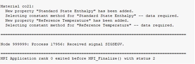

SubscriberHello,
I want to use the RGP table for two-phase CO2 simulation in the tube. I generated the RGP table and import the table in the Fluent by Table file manger. When I choose the two-phase option on (VOF) and energy on, Fluent will close itself by giving the following error.
Could you help me?
Best regards
Abbas

DrAmine
Ansys EmployeeWhich version? -

abbas
SubscriberHello Amine,
ANSYS 2020 R1

abbas
SubscriberDo you think, it's a problem related to the FLUENT? Because I have done two-phase flow simulation in CFX with the RGP table.

DrAmine
Ansys EmployeeYes I think it is related to Fluent. As I said I will update whenever I have something to share. Thanks for patience.

DrAmine
Ansys EmployeeThe problem is now fixed. The fix will be available within the next version.
