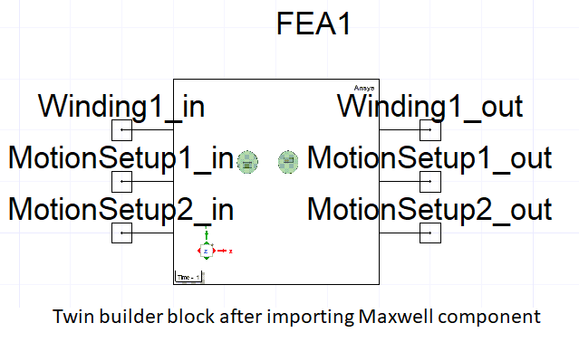

I have to assign 2 motion set-ups on a Ansys Maxwell model, to Ansys Twin Builder. As there is a transient-transient co-simulation, I cannot define Motion Set-Ups in Maxwell, and I will have to define the Motion Set-Up in Twin Builder. I then get this error on Twin Builder:

We could define two motion in Maxwell model, and then Twin Builder could do coupling. Two motion of Maxwell model should not be overlapped.

Here is the answer. We may not do two motion in Twin Builder, but it works in Maxwell.
