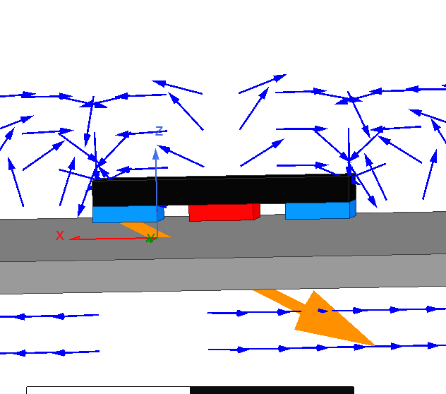

      Can anyone point me to some tutorials on how to quickly run simulations of permanent magnets with and without a yoke relative to a steel wall? I would like to do something like this, but this is only in Ansys AIM. How do I do this in Ansys Maxwell? https://www.youtube.com/watch?v=tp4HxNpg_mE&t=50s
      Below is what I'm trying to do, but for some reason I'm only getting low value numbers
    • NKC
      Hi @connocra You can refer to the inbuilt maxwell example "Ex_MS_1_Magnetic_Force"
      To understand how to set up a permanent magnet and steel combination and perform magnetostatic analysis.
      Go to File>Open examples>Maxwell>General and select "Ex_MS_1_Magnetic_Force"
      Also, refer to the maxwell help for relevant topics.
      Regards Navya
