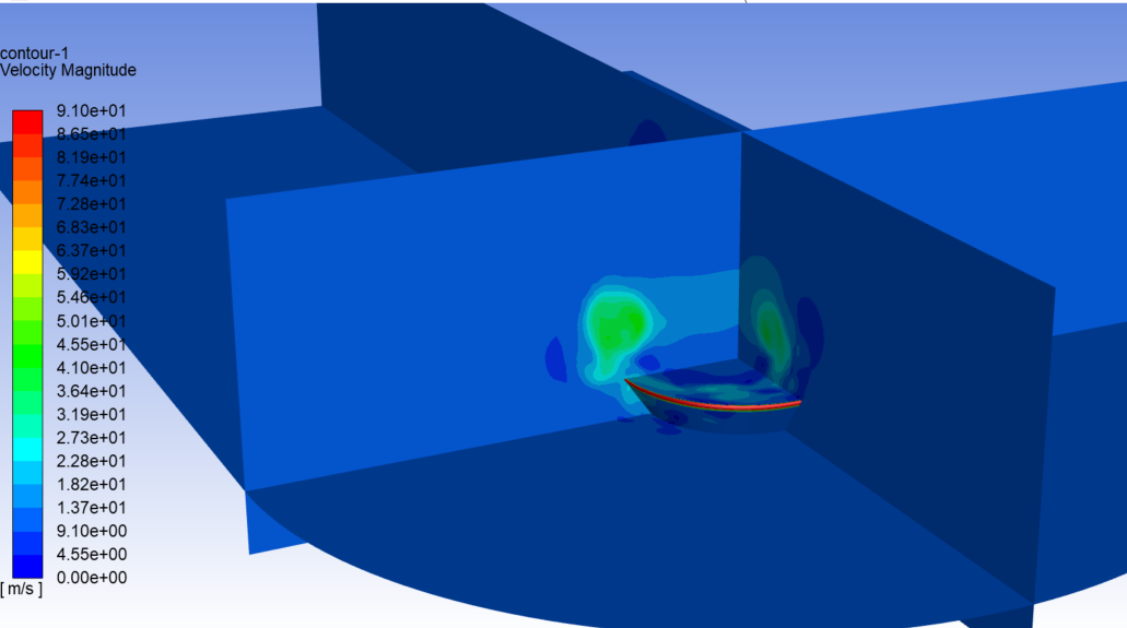

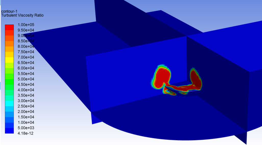

SubscriberI am trying to calculate coefficient of performance for a vertical axis wind turbine. The turbine blade is 90 meter long. While running simulation in fluent, initial residuals are converging well. After a while, the warning appears saying 'turbulent viscosity limited to viscosity ratio of 1.000000e+05 in XXX cells'. I checked the areas where the turbulent viscosity ratios are very high. Initially it is around the interface area where I am using sliding mesh interface. Then the number of cells keeps on increasing, mostly outside of inner rotating domain. I found on the internet that it could be because the turbulent eddies are not being properly resolved as a result of large mesh size or non-uniformity of mesh. I checked the non-uniformity of mesh around the interface and refined it. The problem was still there. I also tried reducing the time step, increasing or decreasing relaxation parameters, altering turbulence model but couldn't get out of the problem. I am getting the results from the simulation, but I am sure the results are non-physical. What could be the issue causing high turbulent viscosity ratio. Is it because of two interfaces having different distribution of mesh or the shape of interface?

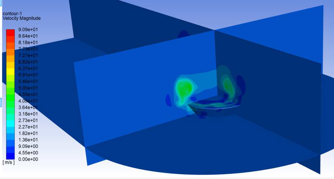

Hi Rob,
Thank you for answering my queries.
The first two figures are velocity contours in a quadrant formed by X=0,Y=0 and Z=50 m planes and inner rotating domain. First figure has rotating domain inner interface and second figure has rotating domain outer interface. The velocity magnitude at the sharp edges of rotating domain are different for inner and outer interface. Is this only the transient condition, or the one causing the real problem because of incorrect flux transfer between inner and outer domain? If so, how can I make interface better?
The another figure is of turbulent viscosity ratio on same plane.
I could actually increase the limiting value of viscosity ratio, but I read somewhere that the flow causing this kind of viscosity is unreal. I can be wrong. I will increase the limit and try the simulation once.

Ansys EmployeeIncrease the value and check if it levels out or not, first. Also make sure that the level of turbulence in your domain at start is not so high. You might start with higher dissipation.
