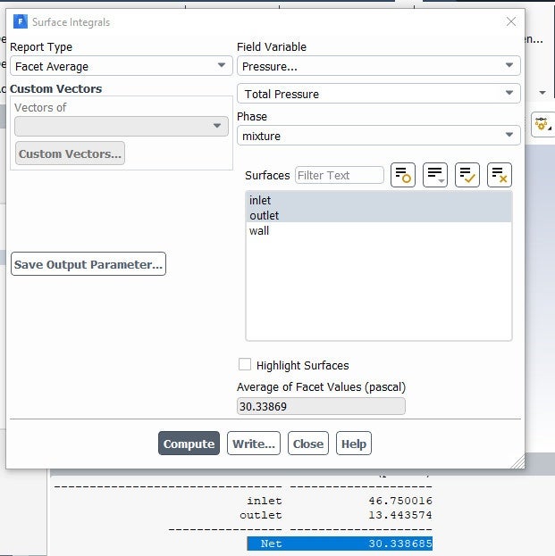

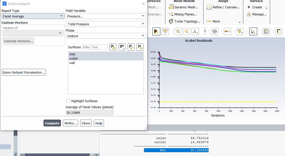

Turbulent channel flow over hydrophobic surface. Even though I changed the contact angle, the result
November 4, 2021 at 8:46 am
bekir4260
SubscriberNovember 4, 2021 at 10:25 amAmine Ben Hadj Ali
Ansys EmployeePlease insert the pictures in the text. Ansys employees do not download attachements.
November 4, 2021 at 12:07 pmNovember 4, 2021 at 2:11 pmAmine Ben Hadj Ali

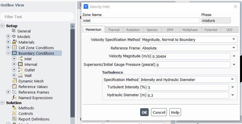

Ansys EmployeeI do not understand what do you expect here? Do you have a multiphase case? Are you injecting anything? How are you using the contact angle information to affect the total pressure drop?
November 4, 2021 at 4:19 pmbekir4260
SubscriberI am interested in the plumbing business.
I am looking for ways to reduce the pressure loss in the installation.
I coated the inner surface of the pipe piece with hydrophilic structure with hydrophobic material.
hydrophobic material prevents water from sticking to the surface.
friction on the inner surface of the pipe is reduced.
no slip condition.
I tested it on 3 different surfaces with 3 different hydroobic materials.
Friction and pressure slip were the least in the pipe with the highest contact angle.
now i want to model it with fluent.
The only place where I can enter the contact angle in the fluent program is the VOF model.
In fact, only water is flowing.

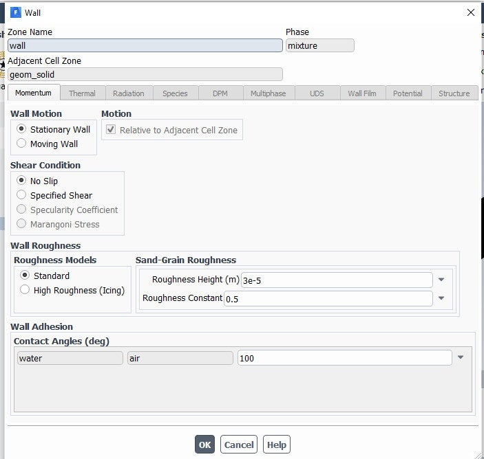

November 4, 2021 at 5:00 pmRob
Forum ModeratorContact angle is set between phases. If there's no meniscus the value is meaningless.

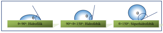

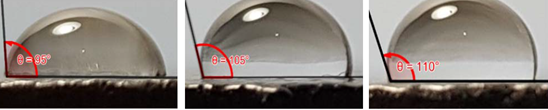

hydrophobic surface means:
the surface is in nano-sized rough structure.
air is trapped in the roughness during the flow of water, so the water does not stick to the surface and the surface does not hold water.
In fact, only water flows on the surface.
Air is trapped in the spaces between the water and the surface.
I am attaching the hydrophobic surface and velocity profile photo.
November 8, 2021 at 9:31 amNovember 8, 2021 at 9:55 amRob
Forum ModeratorCorrect. However, if you read the Fluent manual you'll find we measure contact in the droplet. If the surface is fully wetted there is no free surface to attach the angle to. You'll also see the section explaining how the VOF model works.

November 8, 2021 at 3:33 pmRob
Forum ModeratorBest approach is probably to alter the wall shear rates in the boundary condition panel.
November 9, 2021 at 8:06 amNovember 9, 2021 at 1:36 pmRob
Forum ModeratorWall conditions, you'll need to alter the wall Shear Conditions, that may require a UDF or expression. And, no, we don't have the expression, you'll need to figure that out.

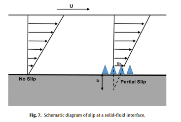

November 9, 2021 at 3:55 pmAmine Ben Hadj Ali
Ansys EmployeeYou will rather need to code a wall shear stress to incorporate the effects on the momentum equation instead of using multiphase model for applications where only one phase is present (Navier Slip implementation).

November 10, 2021 at 12:04 pmJSMacdonald

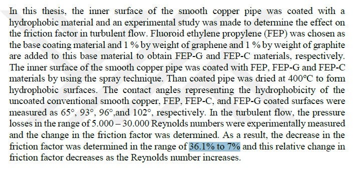

SubscriberI think you've got a really interesting problem but I don't think it's as straightforward to solve as you'd like it to be.
I found this paper which has some pertinent aspects for your problem. https://journals.sagepub.com/doi/full/10.1177/1475090217740470
Specifically, it shows development of a user defined function for "╬▓- the sliding coefficient, which depends on the wall surface properties", used to calculate shear rate.
Also from the discussion section
"There is no straightforward correlation between the CA and the slip length. However, as an example, Ou et al.23reached a slip length of 20ÔÇë╬╝m with a surface having CAÔÇëÔëêÔÇë160┬░. Therefore, it can be expected that the above-mentioned fabrication methods with CAÔÇë>ÔÇë160┬░ are capable of producing slip lengths greater than 20ÔÇë╬╝m."
It sounds to me like there is not an established way to link shear rate with 3-phase contact angle (or surface energy, which would be the more appropriate parameter here).
As I don't work for Ansys I can also say that I think your experimental conclusions sound dodgy
"As the contact angle increased, the friction on the inner surface of the tube decreased." Why is this?
"air is trapped in the roughness during the flow of water, so the water does not stick to the surface and the surface does not hold water." This is for the superhydrophobic regime, however at the contact angles you mention you are in a fully wetted regime.
It would be good to get your thoughts, good luck with the model
