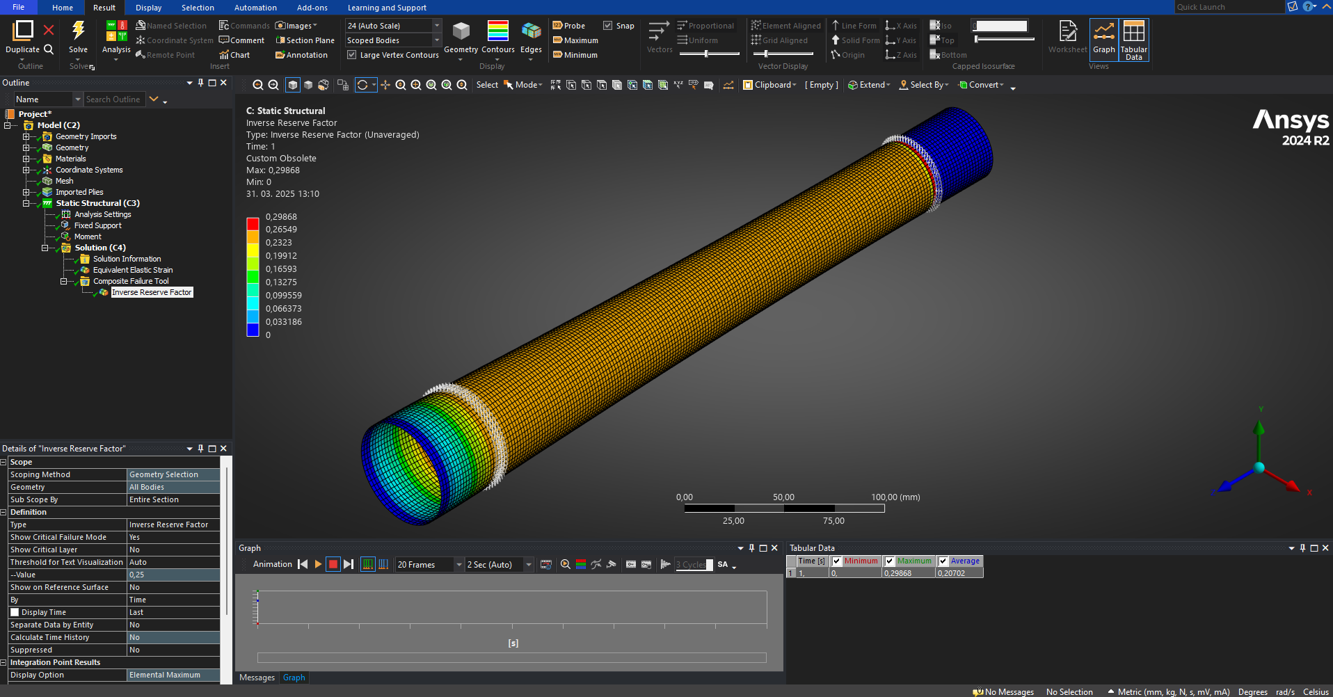

SubscriberHello! I am working on a composite pipe and would like to test it in Ansys to insure it withstands all the applied loads. By definition of the Tsai-Hill and Tsai-Wu criterions, failure presents when the value reaches 1. I remember running the simulation a couple of months ago, and that was true also in Ansys. But now, it shows failure when the value surpasses 0,25 and I don't trust the results anymore. I checked the Tsai-Wu constant values and they are the same (all -1) to the carbon I worked with previously, when the value of failure was still 1. If anybody has an idea why that changed, please explain it to me.

Ansys EmployeeCan you please share your previous results?
Please share some snapshots.
