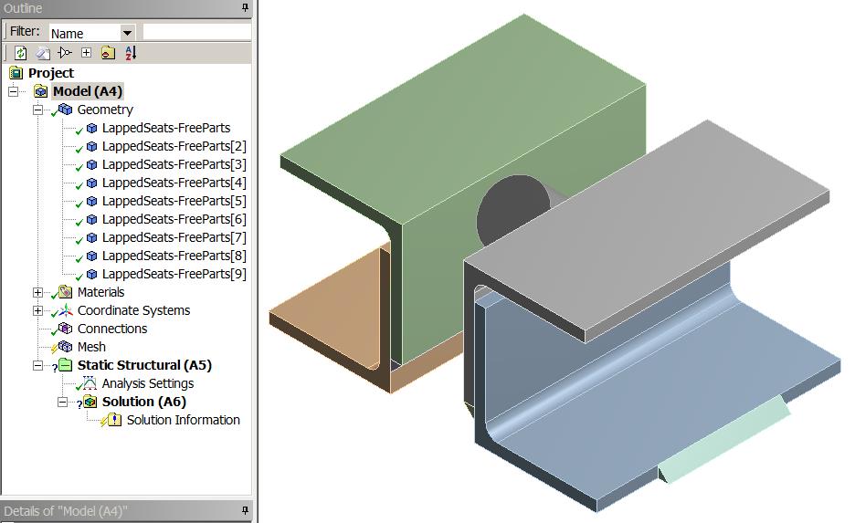

      Hi All,
      I am not sure why my geometry doesnt open in ANSYS mechanical.
      Sam

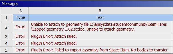

    • Sam Fares
      Below is the message!

      ANSYS experts,
      SpaceClaim opens and I can see the geometry. I saved a SpaceClaim document, created a new Workbench file with a new Static Structural and Imported that SpaceClaim file into the Geometry cell.  When I Refreshed the system I got errors:

      I went back to SpaceClaim and used the Repair tab to check for various defects. Only Split Edges showed something, which I repaired, but that did not help the geometry to transfer to Mechanical.
      Sam,
      Open SpaceClaim, Save As STEP file.  Open a new Static Structural analysis and Import the STEP file into the Geometry Cell. That successfully Attached to the Model cell.
      You can also open the Geometry in SpaceClaim.
