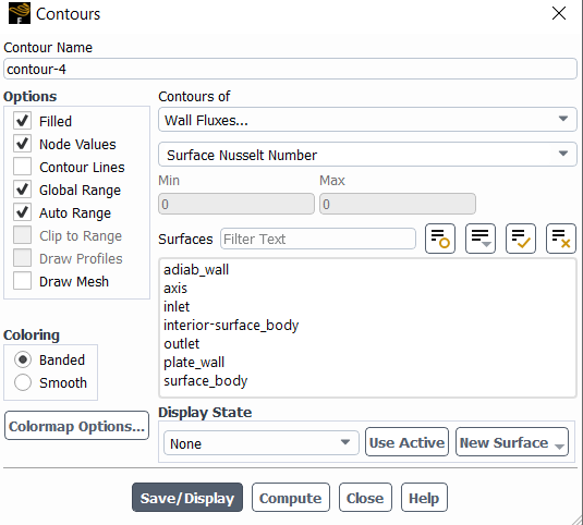

I'm trying to plot a contour of the Surface Nusselt Number under the Wall Fluxes contour tab. However, the plot shows that the Nusselt number is zero everywhere.
The actual flow behavior looks fine. The energy equation is turned on and there is heat transfer in my system.
What could be the problem?

Forum ModeratorCan you check you've got boundary values selected, and also try with node values off.

Assuming you are plotting on a wall, can you plot the wall temperature?
December 8, 2021 at 2:49 pmCopperGenie
SubscriberI believe I have fixed the problem. It turns out I needed to assign a temperature to the wall in addition to the volumetric heat generation for the Nusselt number to show up as nonzero. Thanks!
December 8, 2021 at 4:34 pmRob
Forum ModeratorWhat did you have set on the wall? Setting a temperature shouldn't do anything in itself.
