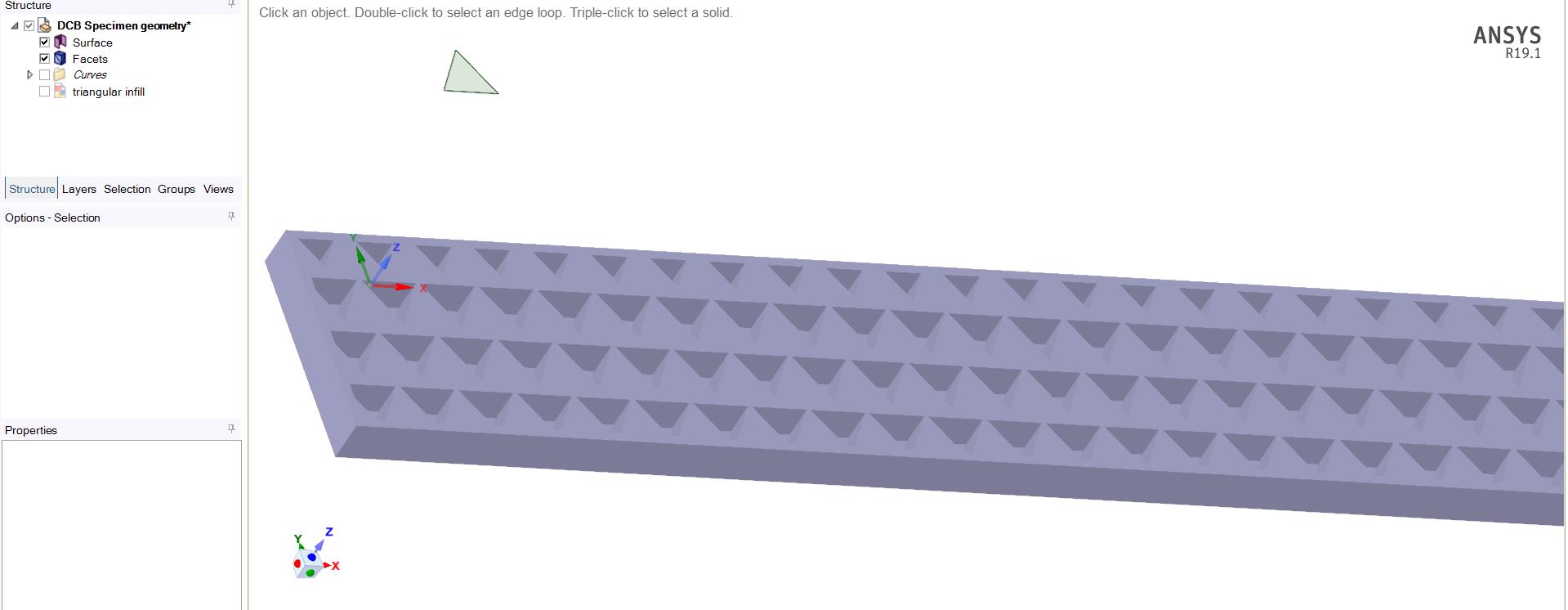

I want to create the triangular infill as shown in the picture below:Â
.jpg?width=690&upscale=false)
 I've followed this video (
) up to the part where I've imported a triangle and generated my infill, but it just doesn't turn up as expected. Specifically, I'm confused about the "thickness" and "length" it asks for.Â
I've attached the work I've done so far, any suggestions or help would be much appreciated.Â
Some background: I'm attempting to simulate the delamination of a DCB specimen. The actual experiment used a 3D printed specimen shown in the picture above, and I'm trying to match my model as much as possible.Â

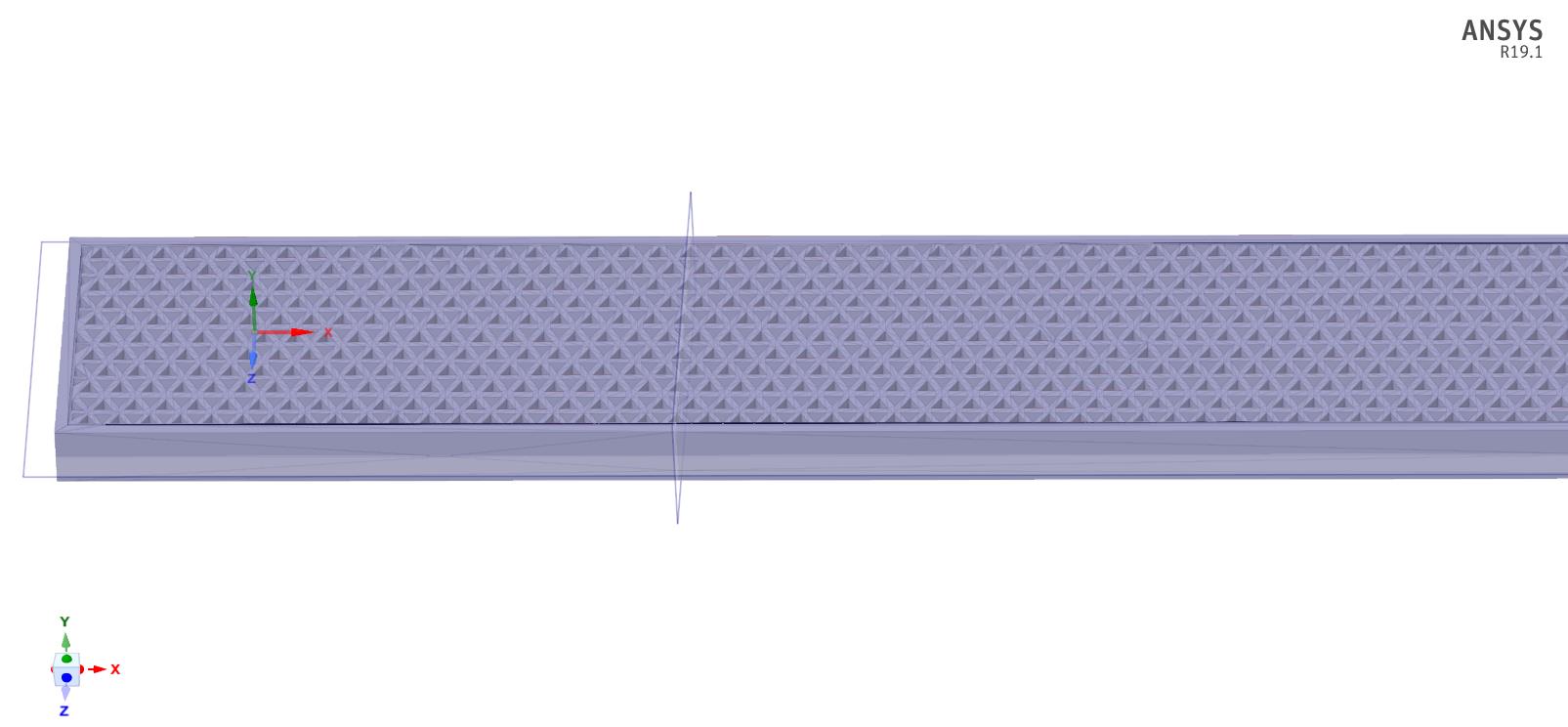

SubscriberYes, here is my geometry ( the triangular surface can also be seen on the top):
Also, like in the video I posted, the z-axis points in the direction I want (bottom to top). The image below shows the preview after I select a thickness of .5mm.Â
Here's the finished product, which is wrong, but I don't know how to fix:

Ansys Employeeits not very clear to me.Â
first you have geometry - a plate and a traingular surface.Â
then you are working on facets.Â
if i understand it correctly, you can do following.Â
use geometry and not facets.Â
create pattern of traingular surface.Â
pull that traingular surfaces to create holes in the plate.
please check if this helps.Â

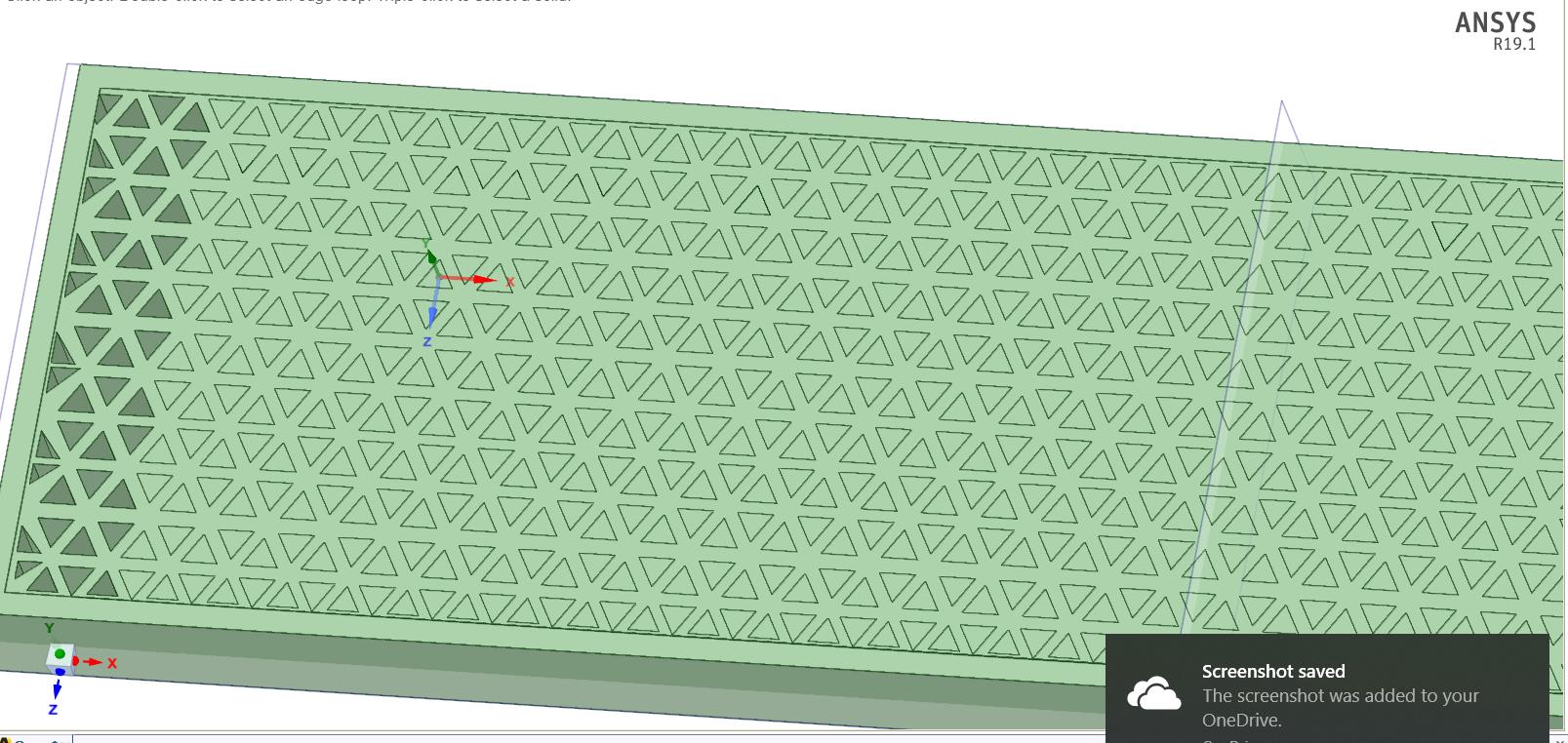

SubscriberThe following is my geometry, but it is a faceted body. I need to convert it into a solid, but whenever I do that (right click on faceted body, convert to solid, merge faces), the geometry ends up strange. How can I fix this?
Notice how some of the triangles are not cut. I tried using the Pull tool, but it wouldn't work:

SubscriberThat looks perfect! Yes I'm using 19.1, which is provided by my school. Will I have to delete my current version of ANSYS to download 19.2?
December 29, 2018 at 3:10 am
peteroznewman
SubscriberYou can install 19.2 and keep 19.1. They will co-exist. But once you save a file in 19.2, you can't open it in 19.1 again.
