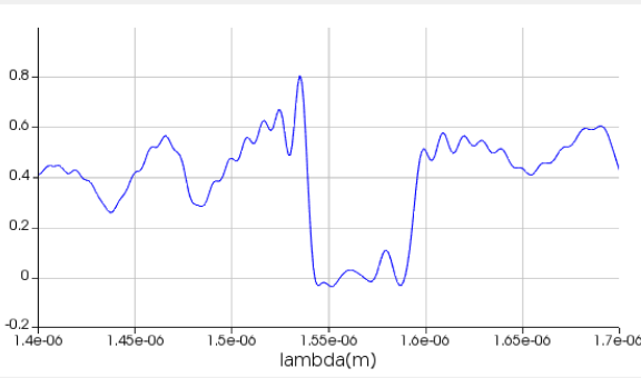

      1. In the transmittance spectrum, a resonant peak should be triggered when I design PhC including the cavity. But, when I do the simulation, there is no resonant peak. So, I cannot calculate the Q-factor instead of using the Q-analysis since I need to prove the Q-factor based on the transmittance spectrum.

      3. From this figure, I cannot find any difference when I do the mode cavity by shifting holes 3,6 and 9nm. How to prove?

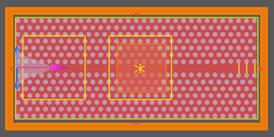

      It seems you only changed the property of 3 holes. this might not be enough to create strong resonance. They are at the end of simulation curretly. You may need to shift the source and the time monitor to right, and set the time monitor in the region of strong resonance.

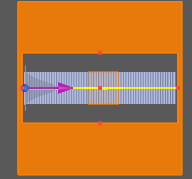

      In general we should use 3D FDTD. The only exception is, the 3rd dimension is very long, in theory it will be infinitely long if 2D is used.
      In general you will need to use override mesh to make sure the discrete mesh is also periodic.
    • Muhammad Danial Haziq Azizan
      means that I need to change the position of the source near my PhC cavity? Yes. I use 2D FDTD cause it takes time to simulate.
