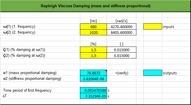

Going by some text and convention, sudden loads in a transient analysis should result in higher stress levels than a static analysis. However, in my case, the results for a static analysis are higher. Could it simply indicate higher/erroneous damping?
My approach (for a 4 ms over-pressurization event) is as follows:
- Modal analysis (mode participation factor) to get the lowest frequency/mode shape, since it is most likely to cause vibration.
- Run a static analysis with appropriate boundary conditions (Large deflections on, material nonlinearity)

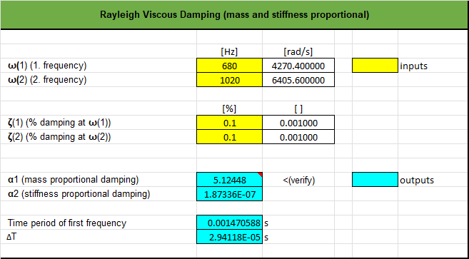

- Use Rayleigh damping and calculate mass/stiffness coefficients based on a frequency range that captures the first two fundamental freq. with 1.5% damping
- Run a transient analysis with appropriate boundary conditions (Large deflections on, material nonlinearity) with max time step that is 1/20th the time period of the lowest freq.
Thank you

Here's my modal data that drives the transient analysis:

Two things come to mind. Yes, the damping, so I would suggest dropping it lower and seeing if that is the contributing factor. Second is even though you expect the most response from the lowest frequency, I would try and reduce your max time step further to make sure you are not missing the peak. I have seen transient results reported that were erroneous because the time step was too large. Let us know if this helps.
Regards Sean

SubscriberSean,
Thank you for the feedback. I repeated the analysis with the following settings:
I significantly reduced damping to 0.1% and time step to T/50 instead of T/20. The results remained unchanged. I suppose this occurs because the thick shaft does not generate a strong response due to high material damping.

Thinking about this further and your statement "sudden loads in a transient analysis should result in higher stress levels than a static analysis". I would say "should" would not necessary be the word I would use. It can be the case that the duration of the impulse is not long enough to produce a response. But in your case it does seem the duration would be. Have you tried to see that if you expand your pulse to say double the duration, if you get an increased response? Not saying we change the problem statement, but to identify the influence. Also, comparing the deformations at the time = .002 s, are you seeing you are still much less than the static deflection, this can help provide insight by making this comparison.

I repeated the simulation with double the time period of the impulsive force, and the results are the same. I'm summarizing my thoughts here for brevity:
The model has a high first fundamental mode ~ 700 Hz so it is less likely to have a strong response. Usually, I've seen models with low first natural modes of vibration (~ 10-20 Hz) generate a strong response to an impulsive load.
The pressure curve is actually a short spike and is being approximated as a sawtooth function for simplicity
Lowering or absence of damping should yield a stronger response for a conservative estimate, which is not resulting in any change in my case
Increasing or decreasing the time duration of the pressure impulse has no effect on the model
