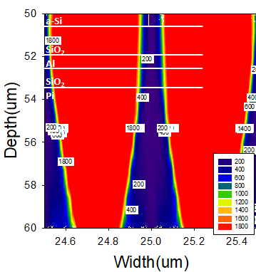

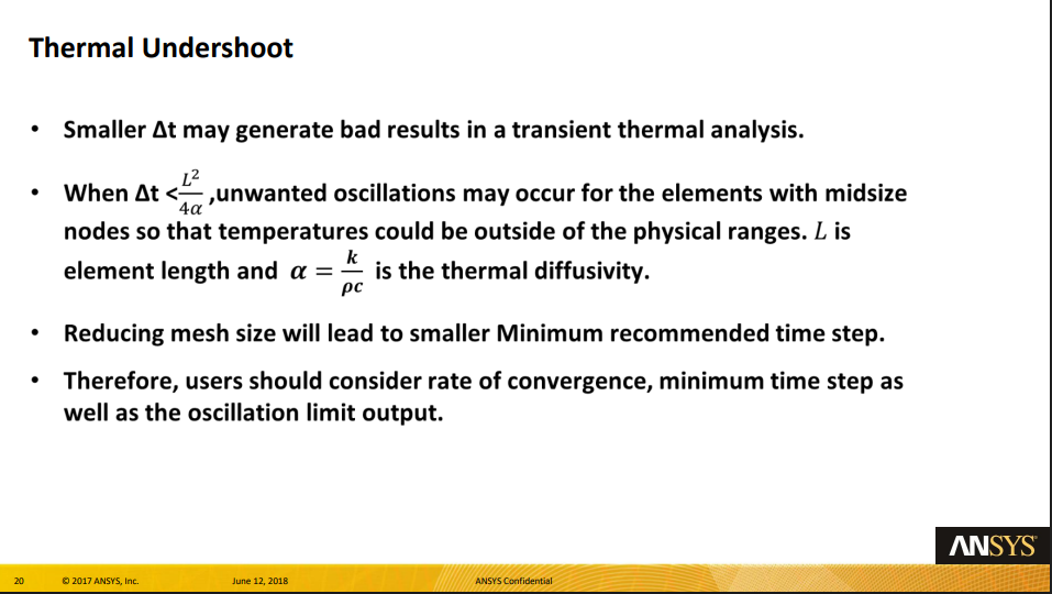

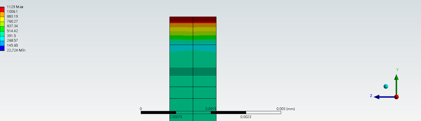

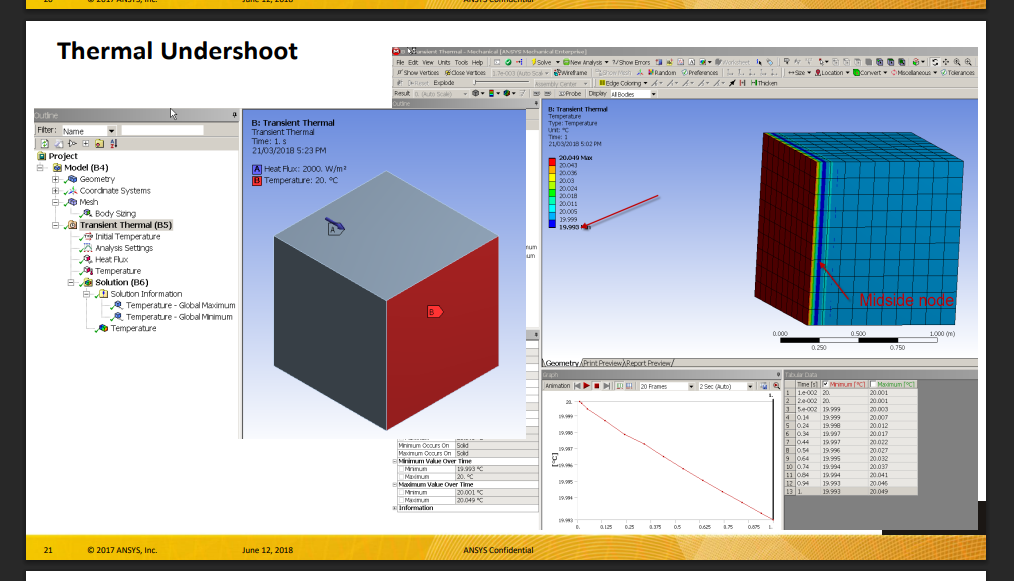

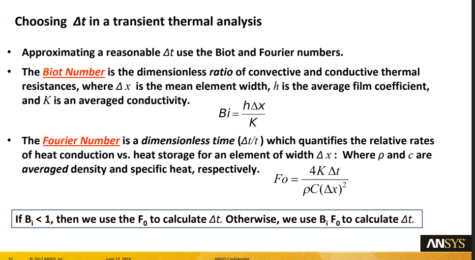

      Hi, recently I've been facing a strange situation in a transient thermal analysis.
      I found a section in the handbook that talks about it (see the pictures below).
      I'm not too sure about the recommended settings.
      To avoid thermal undershoot, I used automatic time stepping instead of manually calculating Bi and F0​ to determine Δt.
      However, after importing the data from ANSYS into SigmaPlot, I ended up with some messy results.
      I could use a bit of help here
      BTW those 2 pics up here is same crosection data, first on is draw by sigmaplot other one is ansys display — big thanks in advance!
    • Ashish Khemka
      Please see if the following link helps: How to address thermal undershoot problem | Ansys Knowledge
