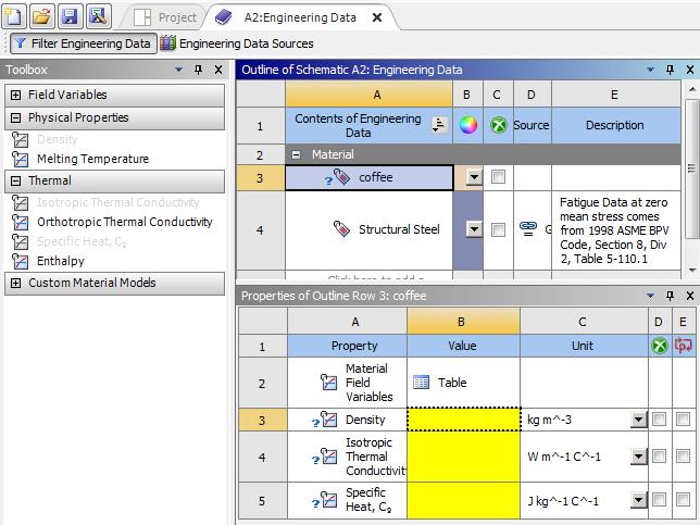

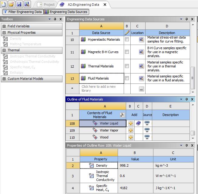

Double click on Engineering Data, a new tab will open in Workbench. Click on the box under Structural Steel and type coffee. The Toolbox on the left has been filtered to only show properties relevant to a Thermal analysis. Drag and drop on the coffee material Density, Isotropic Thermal Conductivity and Specific Heat.
Fill out the values in the correct units in each yellow box. Â
If you don't know those values, click on the Engineering Data Sources button at the top and you can add Water Liquid to the project by clicking on the + button.
Repeat this for HDPE, which you can find in the Granta Design Sample Materials database.

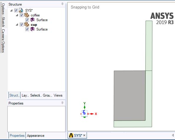

Now you need geometry for the cup and the coffee inside the cup. You can save yourself some time if you create an axisymmetric model.Â

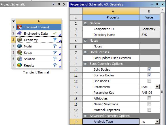

Click on the Geometry cell on line 3 of the Transient Thermal block A. In the Properties window on the right, on line 19 is Analysis Type. Change that to 2D.
Now double click on Geometry to start SpaceClaim. Sketch a radial slice of the cup on the XY plane on the +X side of the Y axis. Think of the Y axis as the axis of revolution. The surfaces you draw would recreate a solid body if you revolved them 360 degrees about the Y axis. Create a New Component for the cup and draw the L shape. Create a New Component for the coffee and draw a rectangle. My cup is half full. Yours might be half empty : ) Activate the cup Component. Draw a line at the top of the coffee to split the face into two so there can be different boundary conditions.

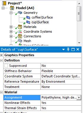

Click on coffeeSurface and assign Water Liquid to the coffee.
Assign HDPE to the cup.

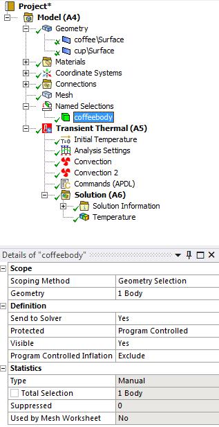

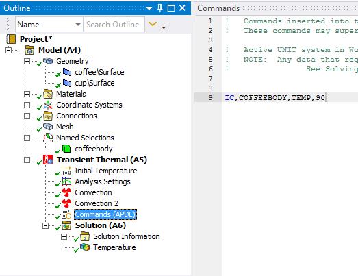

Click on the Body filter and click on the coffee then type N to create a Named Selection named coffeebody
Under Transient Thermal, the Initial Temperature is 22 C. Click on Analysis Settings and choose the Step End Time of 600 seconds.
Click on Commands and type in the command shown below: IC,COFFEEBODY,TEMP,90

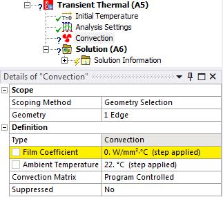

On the Environment tab, pick Convection and pick the top edge of the coffee. Enter a Film Coefficient.
Do the same for the inner top half of the cup, the top and the outer two edges of the cup. Assume the bottom of the cup is insulated. That is the default BC so no action is needed for that edge.

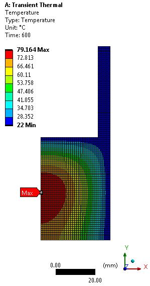

Click Solve. Here is a simple estimate of the temperature of the cup after 10 minutes.
This is a very simple model. A more accurate model would be done in Fluent and would include the convective motion of the coffee inside the cup, where there is a flow upward in the center, outward, then downward near the cooler cup body and inward at the bottom. That would allow the system to cool faster than this model predicts, which only accounts for thermal conductivity through the coffee.Â
An even more accurate model would have the air around the coffee convecting heat away. If you do that, then you don't have to guess at a Film Coefficient. The air flow will carry away the heat.

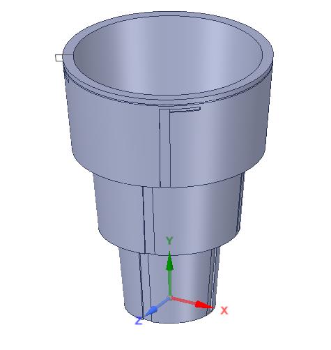

To use the solid to make a 2D model, open the SolidWorks file in SpaceClaim. Create a plane on the XY plane and Split Body, discard the +Z half, create a plane on the YZ plane and Split Body, discard the -X half. Now pick the 1/4 face in the XY plane, and Ctrl-C and Ctrl-V. Now you have the radial slice of the cup. Discard the solid.
