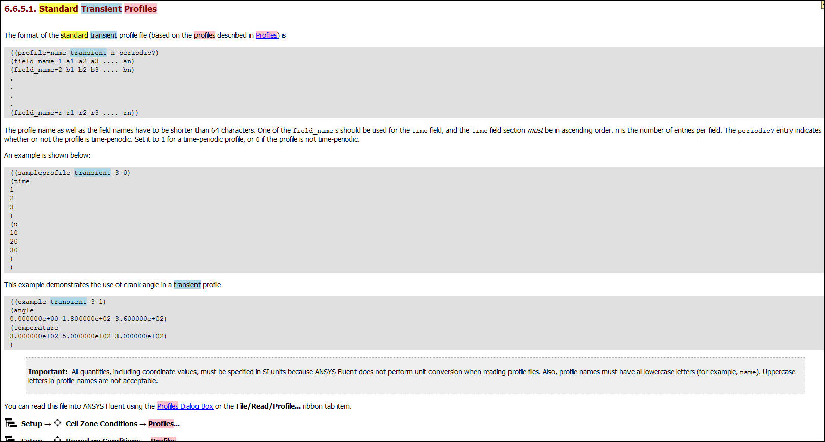

      How to create a transient table for fluent. How do we save it from excel file to .prof format if that is the specification format
    • Keyur Kanade
      Please find following images from help.
      Hope it helps.
      Keyur
    • vguda
      Thank you Keyur for your prompt reply. I have created my table using the same format. How to save it as a .prof file to be read in file>re-trans-table TUI command. It is not recognizing when just saved as text file.
    • Keyur Kanade
      Try by changing extension.
    • vguda
      That didn't work. However I tried writing a profile file from Fluent and opened that file in wordpad and changed the data to my data. Then it worked.
