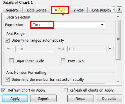

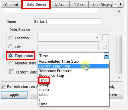

Ansys EmployeeThis step should be done as you setup the case where you can define report definition. If you have the data go to CFD-post read the last transient go to Chart select transient Chart and then expression write an expression of volume average of Temperature then apply -
