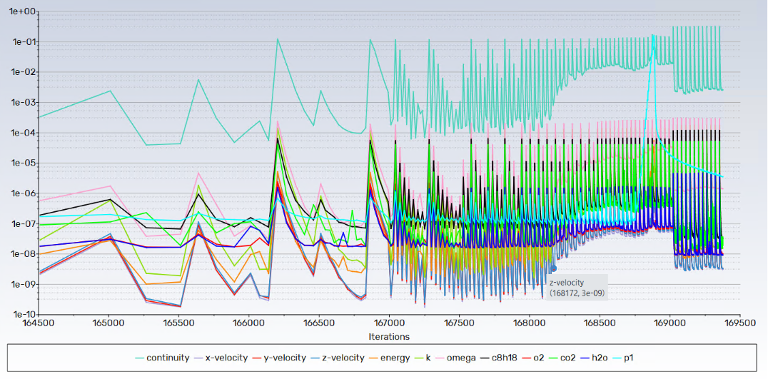

      I have been running a transient combustion simulation for the last five days. I had been varying the time step between 1e-07 s to 1e-06 s and monitoring it regularly. Last night, I kept the time step size at 5e-07 and the residual behavior got worse as the case ran overnight. It comppleted 5594 time steps this morning. Can I lower the step size and continue running this case from 5594? I did have the case served at an earlier time step 5280 (prior to residuals getting worse) so I could start from that time step.

      Before I got to see your reply, I had restarted the simulation with a smaller step size (2e-07). Here is the improvement in the residual behavior.
      The pressure monitor showed some minor spikes but is stable now.
      I'd also monitor fluxes and point data to see how that's behaving.
