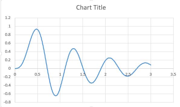

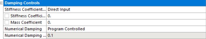

      i have a problem in transient analysis as the output displacement is similar to static analysis and different from hand calculations
      the structure i am analyzing is a cantilever column with point mass at the top with applied transient load at the top of the column and damping ratio of 10%
      for the time step i used 2 initial steps with time integration off from 0 to .0001 & from .0001 to .0002 in order to have zero velocity initial condition and then applied load from the next steps with time integration on
      here are some photos describing the problem
      the correct displacement should be as follows

      i want to conduct a direct integration time history analysis without linking modal analysis solution as i am planning to do a non linear problem and i think i read in mechanical help that both methods "with or without linking modal analysis solution" can be done
      I understand what you want to do. Yes, you can do transient structural with or without linking to a modal analysis but to do any nonlinear computation, the setup must not be linked to a Modal analysis solution.
