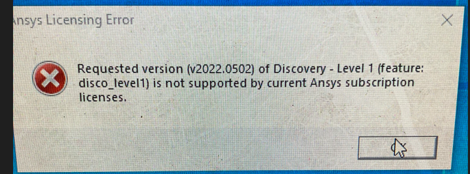

    • dweltch
      hello again Devendra
      this time i checked that the licensing mode is set as subscription.
      i have released both license numbers.
      uninstalled and reinstalled Spaceclaim from the forum page.
      when starting Spaceclaim, i get a error box that will allow me to open the program in view only mode.
      i still am not able to run... what am i missing?  is it that the version is different?
      thank you for all of your help so far!
      • Devendra Badgujar
        dale weltch
        It looks like your license subscription (Tecs date) has expired on 03/08/2022, so you won't be able to upgrade to versions released after this date. The latest you can use is SpaceClaim 2022 R1. You can download the correct installer for SpaceClaim 2022 R1 from this link below:
        Previous Versions - Knowledge Base - Ansys Discovery Forum
        Link no longer exists
        The correct installer will be called ''SPACECLAIM_2022R1_WINX64.zip''
        Also it looks like your license is not activated on any machine. Once you've finished the installation, launch the software. You will be prompted to log in with the email and password of the user account that has the license assigned. Once that's done the software should launch successfully.
        Let me know if you need further assistance.
        Regards.
