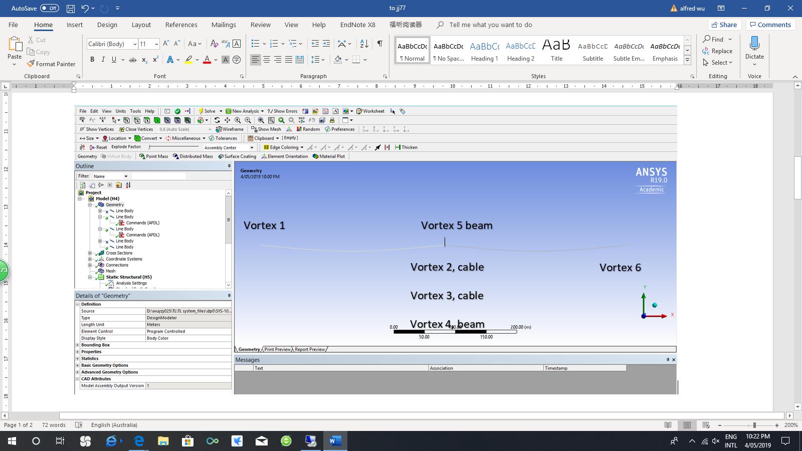

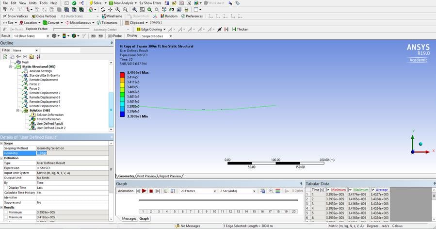

May 5, 2019 at 9:25 am
zw123456
SubscriberÂ
Dear jj77 and Peter,
How are you? Could you please have a look?
1. The result of SMISC1 is 3.4165E5, is it too large for tension force?Â
2. the result is not sensitive for lateral force only along Z axis?
3. The equation for calculation for initial strain, unit less Y is young's modulus, F is pretension, A is section area?
 thanks for help!
 two cables are connected with beam (truss) for transmission line simulation.

 Element:
 Cable: link180
 Beam: beam188 (truss)
 Force 1: (0,0,-4N/m), Force 2: (0,0,-1N/m), applied to line body edge
line body: 3D curve in DM
beam radius=0.03m, cable radius=0.015m
