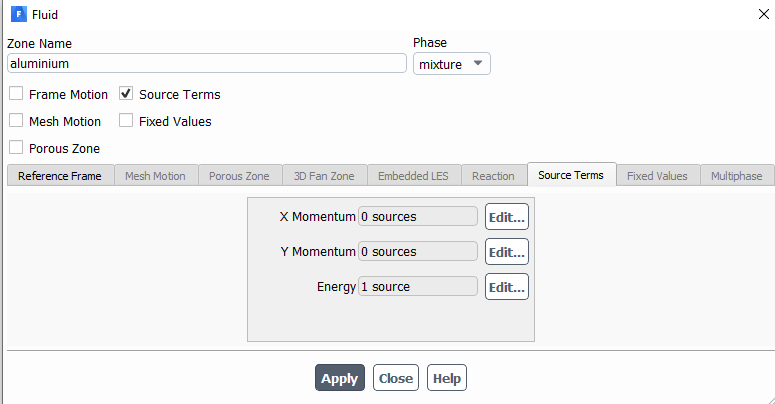

      Hello. Could you please tell me why my DEFINE_SOURCE does not heat the specified area
      source = (950 / (3.14 * 0.0015 * 0.0015) * exp (-2 * (r * r) / (0.0015 * 0.0015)));
      where r = (x ^ 2 + y ^ 2) ^ 0.5.
      This source heats:
      vol=2*r*r/(0.0015*0.0015);
      volume = C_VOLUME(c,t);
      source = (950*exp(-vol)/(volume*0.005))
      THANK YOU.

      Hi!
      Thanks for your reply. This is what I am using.
      #include "udf.h"
      #include "sg_mphase.h"
      #include "mem.h"
      #include "sg_mem.h"
      #include "math.h"
      #include "flow.h"
      #include "unsteady.h"
      #include "metric.h"
      DEFINE_SOURCE(heat_source, c, t, dS, eqn)
      Thread *pri_th, *sec_th;
      real source;
      real x[ND_ND],volume,r,k;
      C_CENTROID(x, c, t);// Acquire the cell centroid location
      real T = C_T(c,t);
      pri_th = THREAD_SUB_THREAD(t, 0);
      sec_th = THREAD_SUB_THREAD(t, 1);
      r=sqrt(pow(x[0],2.0)+pow(x[1]-0.002,2.0));
      k=(pow((3.46/0.003),2.0)); // concentration factor
      if(C_VOF(c,sec_th)>0.55 && C_VOF(c,sec_th)<1)
      if (r<=0.0015)
      source = (950*exp(-k*r*r));
      dS[eqn] = 0.0;
      else
      source = 0.0;
      dS[eqn] = 0.0;
      else
      source = 0.0;
      dS[eqn] = 0.0;
      return source;
      Such a source does not generate heat.
      2 Phase Mode is in use.
      I also found that, before the material melts, X, Y momentum act on heating, even if they do not heat up to zero.
      If you turn off X, Y momentum, turn off heating appears, but still this is not enough.
      The question is, what am I doing wrong? I've spent a lot of time looking into this problem. Heating can be obtained if instead of 950 there will be about 1e10

      I assume it's a steady state problem as there is no time involved in your heat source and you are using VOF for multiphase. Can you tell what are your two phases? Also, please explain in detail your problem statement as that is the basic requirement for anyone else to be able to provide any help. You can see my earlier posts on how to define the problem completely such as what is your purpose? what models you are using? etc.
