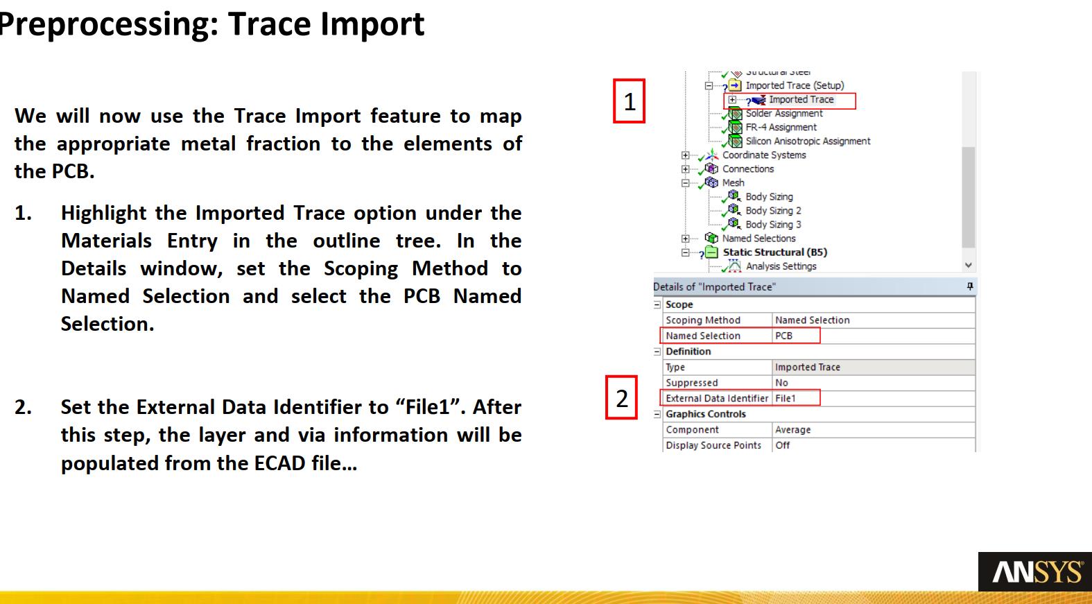

Sriramdlr
SubscriberWould be so kind if some one can help me to find a solution to install trace import extension.
advance,
Thanks.....

Sriramdlr
SubscriberI am currently doing above exercise in ANSYS, which was contacted by ANSYS. Currently I am not able to import the ECAD information. I understood that first we need to install trace import extension. So now how can I import these information into my simulation.
