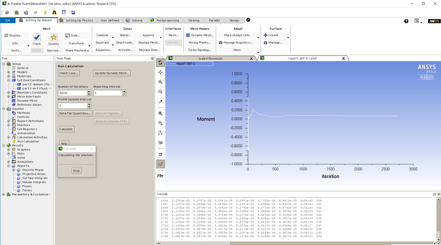

      I simulate two blade wind turbine with MRF.
      but as rotational speed 'omega' increase, torque also increase.
      so there is no peak on power coefficient.
      How can I calculate it?

    • motoyama
      I know the procedure.
      but I've already checked the reference values, no problem.
      and moment itself converged.
      but when rotating speed increase, the torque also increase.
      anyone can help?
    • Amine Ben Hadj Ali
      Your torque is constant from the plot. Can you please add some more information here? If there is a linear momentum then the torque will change even at constant angular velocity.
    • motoyama
      Hi Amine,
      thanks for your reply.
      below is example of angular velocity and torque and Cp values
      what do you want else?
      OK, why should torque be the same for different speeds? Ie, what is the definition?
    • motoyama
      Hi , rwoolhou
      the torque value means half of the moment that i calculate
      well, I think torque is not same as for different speeds.
      from the tip speed ratio, there should be a Cp peak.
    • motoyama
      I add the data.
      I'm not sure I understand.  If you expect the torque to change with speed, what is the problem?
    • motoyama
      the problem is that torque increase and decrease as the rotational speed increase.
      so Cp=torque x omega should have peak.
      but this data shows torque only increases but not decrease.
      From the data you are mentioning I do only detect  single trend: torque is increasing as the angular velocity is increasing (due to linear mometum). So now: What is the problem?
