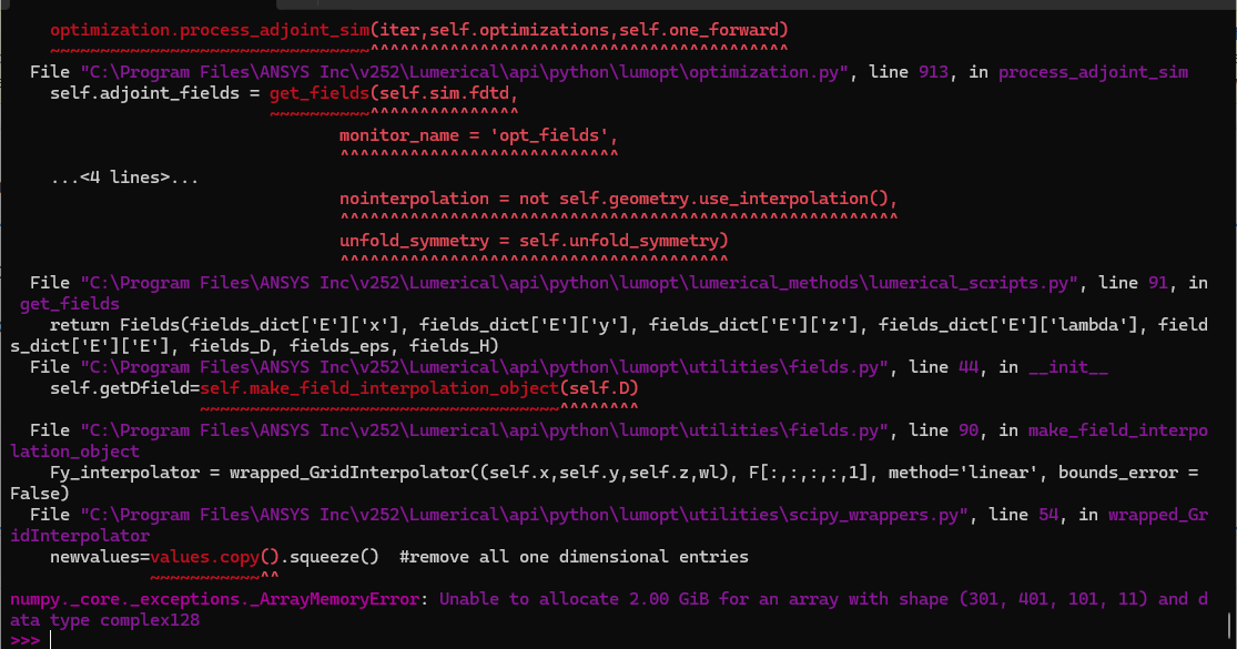

      Dear Ansys Support,
      I’m working on a design similar to the O-band/C-band wavelength demultiplexer described in the following article:
      However, my transmission goal is to achieve high efficiency over the 520–540 nm and 600–800 nm ranges, with each output channel reaching over 95% transmission in its respective band, as shown in the attached transmission plot.
      I’ve already created both the base simulation setup and the Python optimization script. Could you please review them along with my transmission analysis code to confirm if everything is correctly implemented?
      Thank you for your support.

      Dear Ansys Support Team,
      I have two questions.
      First:
      To see the transmission spectrum result, I am using the Python code, and I can already view the result. Do I also need to add a mode expansion monitor?
      Second:
      I am increasing some parameters, such as the waveguide width and height, for my research purpose. When I run the Python code, I get the following error:
      numpy._core._exceptions._ArrayMemoryError: Unable to allocate 2.00 GiB for an array with shape (301, 401, 101, 11) and data type complex128
      This happens even though my computer has 128 GB of RAM. I’m running Windows (C:), where my C drive has 728 GB of free space, and I’m running the code from the D drive, which has 3.56 TB of free space.
      How can I solve this problem? Please guide me properly.
      I am attaching both my base simulation code and Python code.

      Error-
    • Taylor Robertson
      The lumopt pakage will add a mode expansion monitor MEM based on the FOM - frequency monitor you define, and the modes(number, direction) and wavelengths specified in other objects ModeMatch and Wavelengths. It is not necessary to define the MEM explicitly, just like the adjoint source is set-up automatically in the backward sims.
      I have never seen this issue with numpy memory, but it is a Numpy problem and not something we can support.
      numpy._core._exceptions._ArrayMemoryError: Unable to allocate 2.00 GiB for an array with shape (30140110111and data type complex128
      It seems like the only workaround I can tell is exploring ways of reducing the data in the opt_fields monitor. You can do this by making it smaller, making the mesh larger or reudcing the number of wavelengths. For example you probably don't need 20nm mesh in the z direction.
      I will need to look into this a bit further, but for some reason your array is 128bit complex. We could almost certainly reduce that to 32bit float to help avoid this issue in the future.
