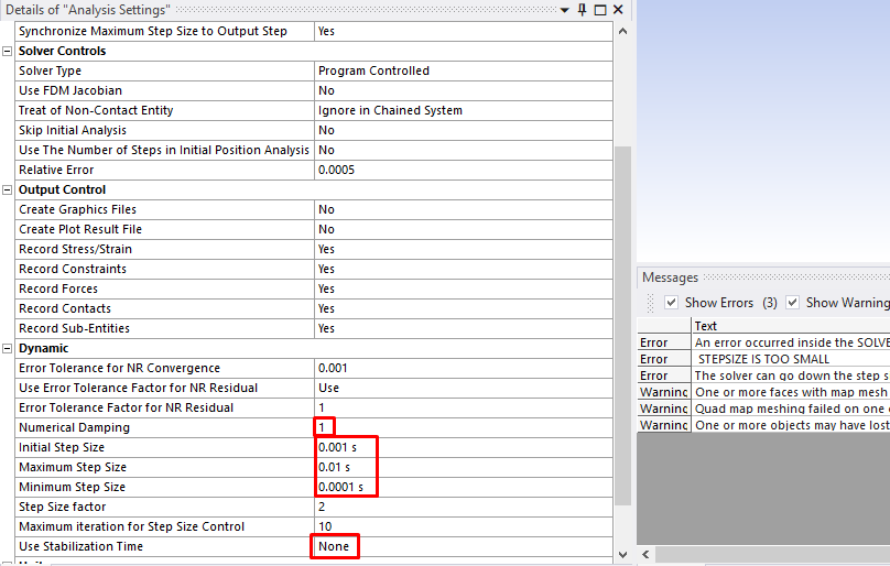

Ansys EmployeeHi,
This is a general error that can occur due to multiple reasons. Please check out the solver output file; there you will find the reason and recommendations to resolve the errors. You can also try reducing the maximum step size.

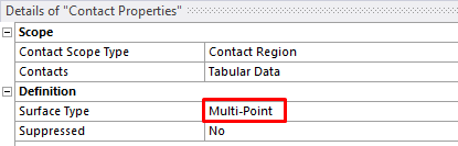

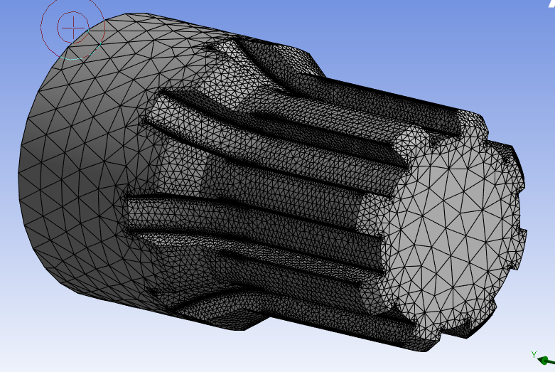

javat33489
SubscriberYes, sir, I understand.
I've also used all the necessary general knowledge on this issue. But it doesn't go away.
I'd like to point out that I've increased the minimum time step, damping, and stabilization:But I always get an error when Multi Point is enabled in the contact settings:
If I use Surface, the problem is solved. But I want to understand why it doesn't work with MultiPoint.
