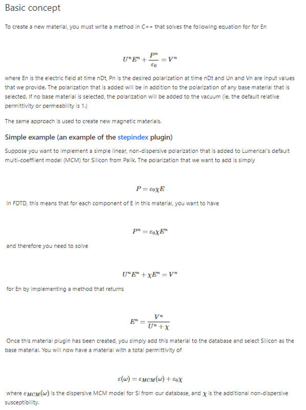

          I was wondering if it is possbile to model the RLC elements to be time-varying. Previously I have tried to model time-varying permittivity using the material plug-in (), and have fully understood how to update the equation for En. So can we do similiar things for RLC element? .

      I belive the Plugin Framework does not support 2D materials. The best thing one can do is probably convert the 2D sheet properties to 3D volumetric properties and modify these parameters in time. Please correct me if I am wrong.
