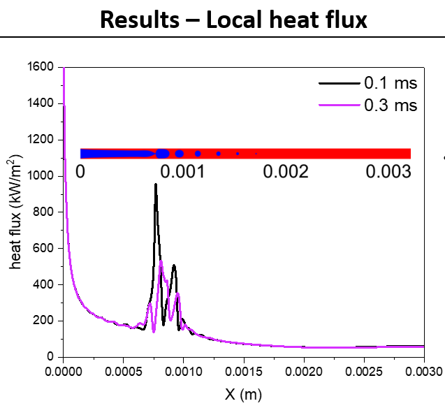

I'm running the transient simulation for condensation in the microchannel. The simulation is ok and I got the graph for the local heat flux. But, I want to calculate the time-averaged wall heat flux? Honestly, I don't know exactly how to calculate the time-averaged wall heat flux from the local heat flux. Is there any way to do it in post-processing? Or do I have to calculate it separately?

Ansys EmployeeIf you have already your run finished and you have report file for local heat flux: just use third party program or python to do the averaging over time. I assume the local heat flux is vs flow time so make the time average out of it using any integration rule.

Ansys EmployeeOkay then you need to create a mean heat flux at each position: you can do that with Fluent Data Sampling. If you do not want to repeat the run: you need to sort it out "outside" of Ansys Fluent.
