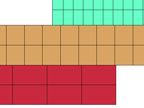

      I'd like to apply 'tied' between solid as below in explicit solution (drop simulation)
      I'm currently using 'TIED_SURFACE_TO_SURFACE_OFFSET'
      And I'm considering using 'TIED_SURFACE_TO_SURFACT'.
      Which one is most recommended, including other contact cards?
      Thanks.
    • Reno Genest
      For tying solids with no gaps between them it does not really matter if you use TIED_SURFACE_TO_SURFACE or TIED_SURFACE_TO_SURFACE_OFFSET, unless you plan to have other constraints (SPCs, etc.) on the same elements. You can test the different contacts and see for yourself.

      Note that an OFFSET contact will retain the initial gaps present in the model/mesh.   Without OFFSET, any node on the slave side which is close enough to tie (there is a closeness criterion based on element dimensions) will be projected to the master surface so as to close the gap.
      You'll get a warning message for any slave node which is not close enough to the master surface to tie.   When defining tied contacts, it's good practice to ONLY include nodes (or segments) on  the slave side that you want to be tied to the master surface.   That way, the aforementioned warnings (if you get any) are more meaningful, and furthermore, you don't run the risk of tying nodes you don't want tied.
      Below is a description of each of the tied contact types,which may also help explain the differences:
      *CONTACT_TIED_..._TO_SURFACE:   constraint-based, and slave nodes will be projected to master surface during initialization.
      *CONTACT_TIED_..._TO_SURFACE_OFFSET:   penalty-based, and slave nodes will NOT be projected to master surface during initialization.   In general, we don't like to use this type of contact as it doesn't consider the moments induced by the gap between slave and master.
      *CONTACT_TIED_..._TO_SURFACE_CONSTRAINED_OFFSET:   constraint-based, and slave nodes will NOT be projected to master surface during initialization.
       If the "..." above is NODES_TO_SURFACE or SURFACE_TO_SURFACE, the rotational DOF of nodes are not considered in the contact algorithm.   That's fine if you're tying solids to solids.
      If the "..." above is SHELL_EDGE_TO_SURFACE, the rotation DOF of nodes ARE considered in the contact algorithm.   That what you want if shells or beams are included in the contact.
      *CONTACT_TIED_SHELL_EDGE_TO_SURFACE has a BEAM_OFFSET variation that is penalty-based, and and slave nodes will NOT be projected to master surface during initialization.
      Constraint-based tied contacts should not be used in explicit analysis IF there are other constraints (SPCs, prescribed motion, rigid bodies, etc) associated with the slave or master surface.   Otherwise, they should be fine.
      Penalty-based tied contacts don't interfere with other constraints."

      TIED_SURFACE_TO_SURFACE is constraint-based while TIED_SURFACE_TO_SURFACE_OFFSET is penalty based. If there no rigid bodies or other constraints involved, TIED_SURFACE_TO_SURFACE would be more advantageous because it won't affect the stability of the explicit scheme. On the other hand, if the penalty stiffness of TIED_SURFACE_TO_SURFACE_OFFSET is scaled up (to reduce any relative displacement), the stability may be compromised and the explicit time step may need to be reduced.
