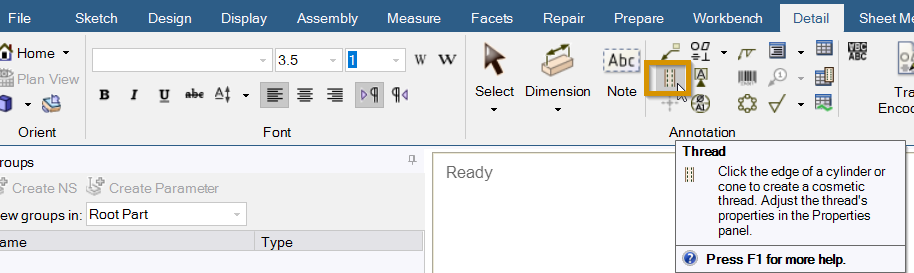

      You can use the Thread tool in Details tab in SpaceClaim to create a thread.

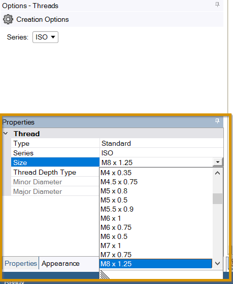

      Additional options in the Properties section allow you to set the size and type of the thread.
