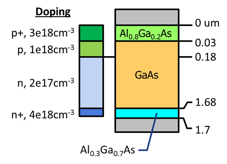

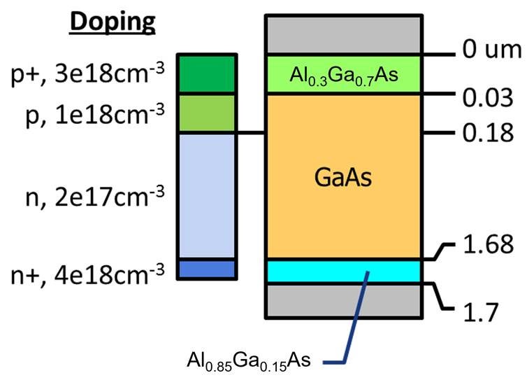

      I am examining the thin-film GaAs example, and it seems that in the simulation file, the geometry labeled nAlGaAs (with the material defined accordingly) overlaps with the p+ layer, while the pAlGaAs overlaps with the n+ layer. Is this an error?
      When I switched the geometries and the materials accordingly, the efficiency dropped below the figures listed for the ideal case. I'm confused about what's going on. I was having trouble replicating the simulation results as provided in the article.
      Could someone from Ansys clarify this?

      Dear Sanjum,
      Do you mean the CHARGE simulation file? It seems you are correct and the structure does not correspond to
      A diagram of a cell
AI-generated content may be incorrect.
      but to:
      A diagram of a substance
      I will ask the authors if they can update it.
