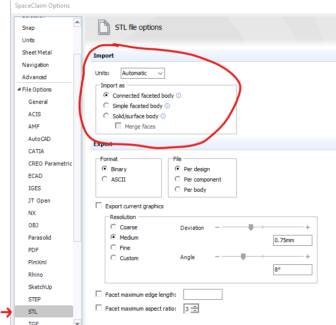

       In SpaceClaim Options > STL, please see if you can manaully set the desired Units and adjust the Import As method.
