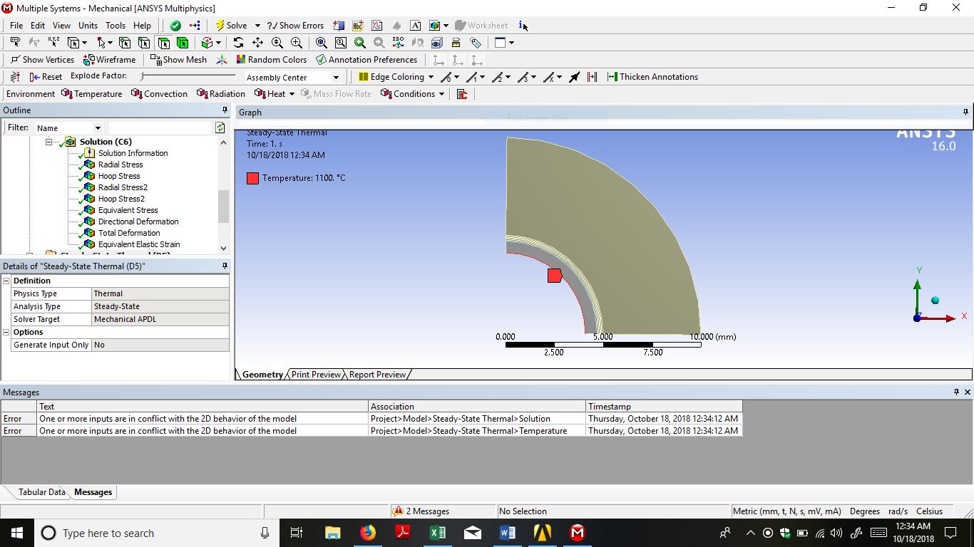

      I made a plane strain 2D cylinder model where i applied internal pressure but when i applied temperature at the internal edge then i got error. But i want to get the thermoelastic characteristics results. Here I am giving a snapshot and attaching my file too.

        Can you click on 'Show Errors' button at the top and see what it says? Also, can you show the details of the temperature you have input?

      I have attached the archive file sothat you can see what is the problem. Ok i am gonna reply you with the details of the error. I had applied 1100 deg cel at the point A and 100 deg cel at the point B.

      I noticed that in a Steady State Thermal model of 2D geometry, Mechanical will not allow a Temperature BC to be applied to 2D Plane Strain Geometry, but it will allow a Temperature BC to be applied to 2D Plane Stress Geometry.  This is the "error" that is troubling Md Ahad, the ? on the Temperature BC. I don't know why Mechanical would allow one but not the other, perhaps you can explain it.
      If the temperature solution is to be used in a downstream Plane Strain model, the link must only be the SS Thermal Solution to the Static Structural Setup cell in order to have the freedom to have the SS Thermal model be Plane Stress while the Static Structural is configured to be Plane Strain. You can't have the Model cell link from Thermal to Structural because then you can't do a Plane Strain Static Structural solution. See the first few posts in this discussion.

        Indeed, it is given in the manual that we only support plane stress and axi-symmetric behaviors only for 2D
        I can't think of a reason why this has to be limited though. I will talk to my colleagues and file an enhancement request with development as needed.

      I think the reason you can't have a SS Thermal model with a 2D Plane Strain model is because in Plane Strain, the surface bodies have no thickness property, the depth is infinite, while in Plane Stress, the surface bodies do have a thickness property.
      In SS Thermal, you can apply a Heat Flux and a Heat Flow boundary condition. While Heat Flux is in the units of W/mm^2, the units of Heat Flow is W.  How many Watts does it take to heat an infinitely large area?  That is the problem and the reason why you are not permitted to have 2D Plane Strain in SS Thermal.

        Indeed, that is what I've been able to find out as well and was about to update here and then saw your post :-)
