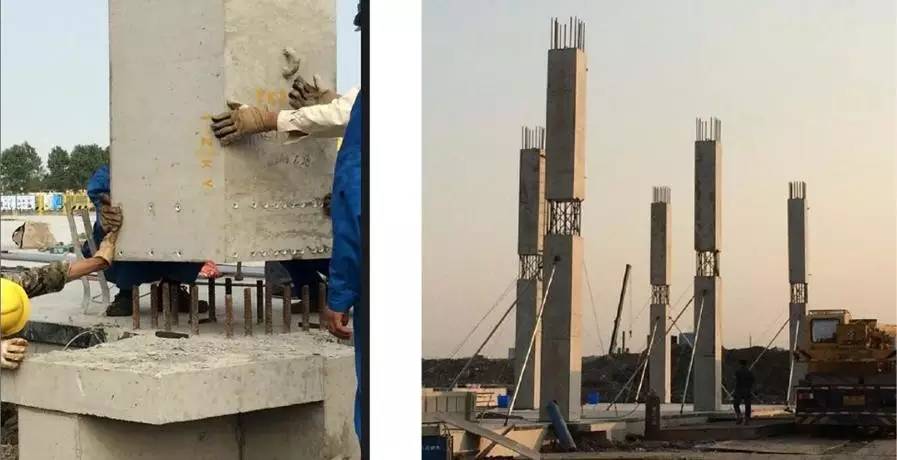

    • qianduoduo
      Thanks for the photographs.
      How about some definitions and more images?

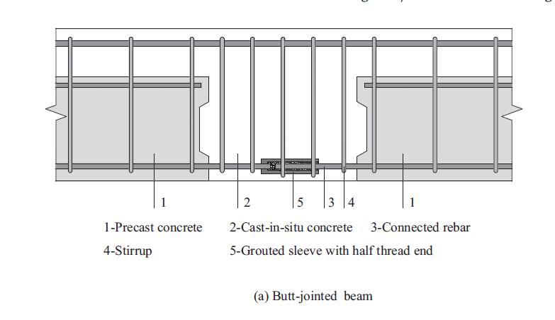

    • qianduoduo
      like that ,how do I simulate the thermal coupling of it
      Okay, this is a good start.
      5. Is the sleeve steel?  It threads onto the rebar on the left, the connected rebar is inserted into the sleeve and the grout fills the gap. Is that right?  Does this grout get cured before the Cast-in-situ concrete is poured?
      4. How is the stirrup connected to the rebar?  Is it welded?  Is it a hook shape that just hangs on the rebar?
