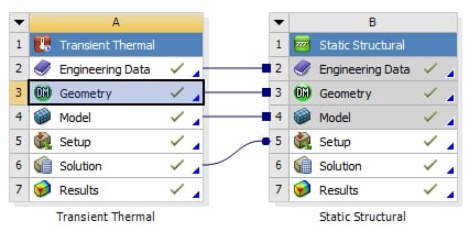

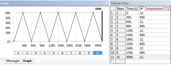

      I will create an example that has 10 cycles.
      Use a Transient Thermal analysis block. Under Analysis Settings you can specify Number of Steps = 10. Step 1 has an End Time of 5*60 seconds. Step 2 has an End Time of 10*60, etc. Insert a thermal load, such as Temperature, and in Step 1 type the high temperature, then in Step 2, type the low temperature, etc.
      Solve this model.
      You can drag and drop a Static Structural analysis block onto the Solution cell of the Transient Thermal.
      Make the Static Structural a 10 step analysis with the same end times as the Transient (for simplicity). There will be an Imported Load. Assign the 300 second Source Time of the Imported Load to the 300 second mark of this Analysis etc.

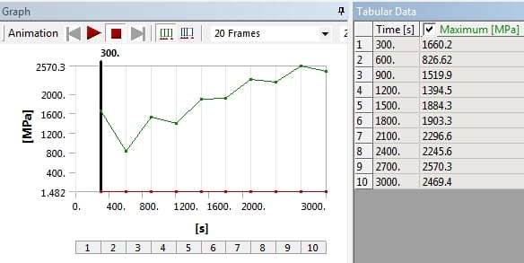

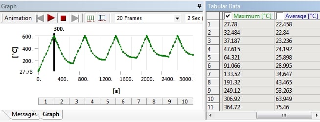

       Here is the time history of the Maximum Equivalent Stress.
      I have to do more research on the fatigue calculation.

      In your example Peter the thermal stress varies almost like a harmonic sinus./cosinus., so one would take the largest peak, say if it is fully reversed (load) or define a fatigue ratio most likely, then use a mean theory (if not fully reversed) and out will come how many of these cycles one can have (stress life). If it is low cycle fatigue, then things are a bit more complex.

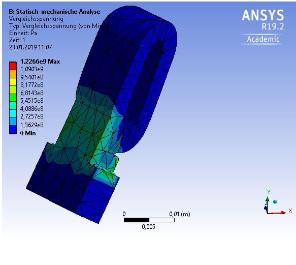

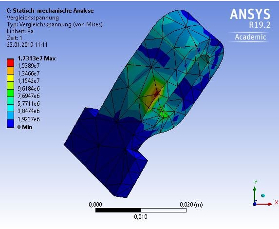

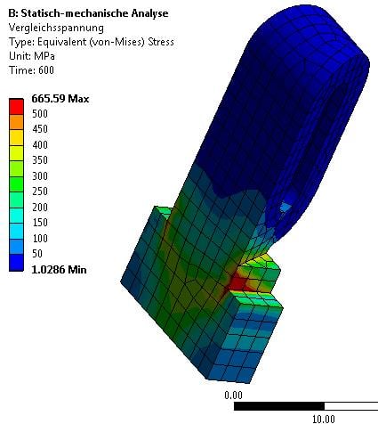

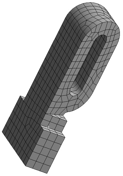

      Peteroznewman .I did an analysis that has also 10 cycles but i found a wrong solution. As equivalent stress i found this
      But actually it is supposed to be like that one
      It is not about the stress values but the stress points or possible damage points.

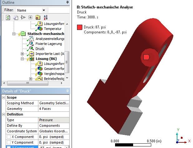

      I have uploaded my analysis under my first post. Could you please say my mistake in this analysis?

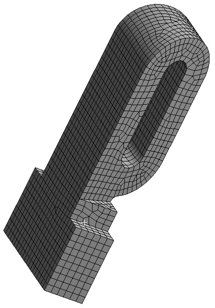

      Thank you for inserting images in your post. Without opening your model, I can say that the mesh is too coarse to get a reliable answer. Make elements at least 2 times smaller as a first result, say start at 2 mm. Under the Mesh Details, there is an Element Size setting where you can do that. The same effect will be made by adding a Sizing Mesh Control and picking the body.
      I see you are on a Student license, so you have to stay below the 32,000 node or element limit. If you add a mesh control Method, pick the body and set it to Hex Dominant,
      Then you can run the analysis again with an Element Size of 1 mm to evaluate if the result changes much.

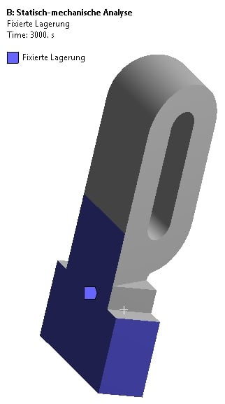

      I don't understand how a pressure load would be applied to some faces and not others. Please describe in more detail how this part is physically loaded.
      Is the part physically welded to an immovable object on the back?  That is what this Fixed Support is doing.
      Please describe how the part is really constrained with other parts in the real world.
      Regards, Peter
    • Ali617
      Hello
      Firstly thank you for your mesh-tips.
      This probe is not welded but stays between two flanges.
      And there is a gas-flow(1323K) which flows inside of flanges. The gas flows from red flange to the yellow one thats why it touchs just front areas of the probes.You can imagine it like a teststand of a turbine of turbocharger.
      Is the gas flow going past the object in the -Z direction?
      If so instead of the pressure that you defined that is Normal to each surface:
      Change the pressure to be in a Component direction
      I see you have a Fluent model started. Obviously, once you get gas pressure from Fluent, you can apply those as a load instead of this pressure, which is just a place-holder for more accurate pressures from Fluent.

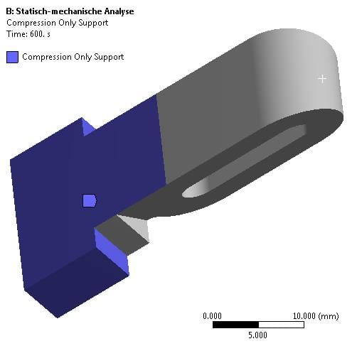

      A slight improvement over a Fixed Support would be a Compression Only support.
      If you do those two changes, you will get a peak stress in the sharp interior corner. Add a blend to the geometry to get rid of that sharp interior corner.
      Regards, Peter
