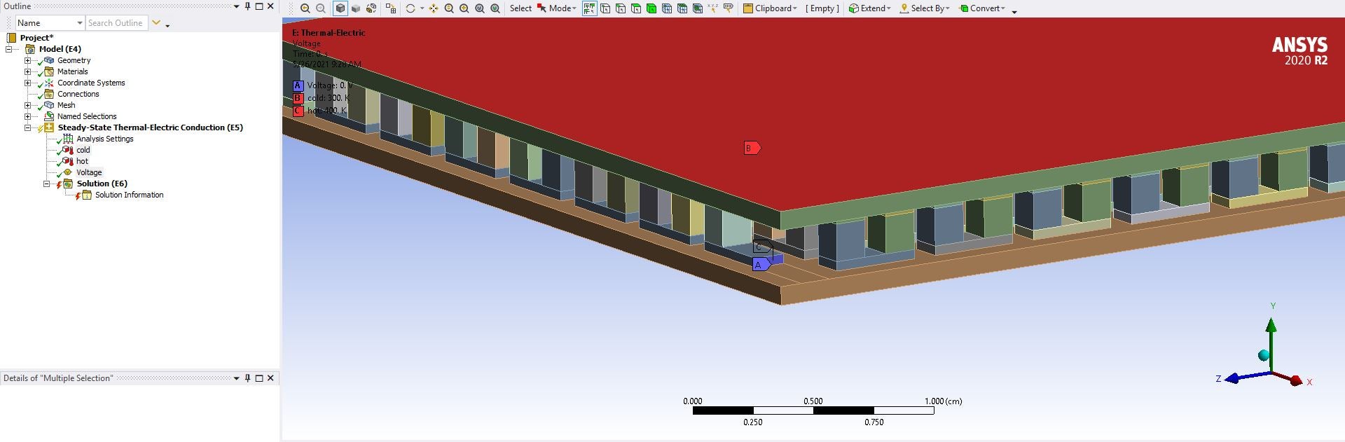

SubscriberHello, I'm trying to simulate a thermoelectric generator consists of 127 pair semi-conductors. I find a tutorial online and try to replicate the boundary conditions. I have three boundary condition which are temperature (hot and cold wall) and voltage with 0 value at the cross-sectional of copper connected to a p-leg wall.

Ansys EmployeeMaybe I'm missing something, but one thing I don't see is some modeled representation of a second electric terminal. It might be necessary to connect some kind of electrical load (e.g., a resistor) across the terminals of the model, so that current resulting from the thermoelectrically-induced voltage can flow, or to at least designate a second open terminal using nodal coupling (couple the VOLT DOF).
By the way, representation of a lumped electrical load such as a resistor requires a command object to define a CIRCU124 element (this is not natively exposed in the Mechanical GUI). The MAPDL Help includes documentation on this element type. I haven't looked at the attached examples for quite some time but from the name of the directory I saved them in, it appears I may have added a CIRCU124 resistor in one or both of them. Perhaps they will help you modify your model so that it converges. It appears they were saved at V19.1, so if you are using a newer version you should be able to restore the attached archives.
Another thing that I find is that for many problems the current convergence criterion is needlessly tight. It can be loosened in Details of Analysis Settings, often without compromising the accuracy of the calculated results.
