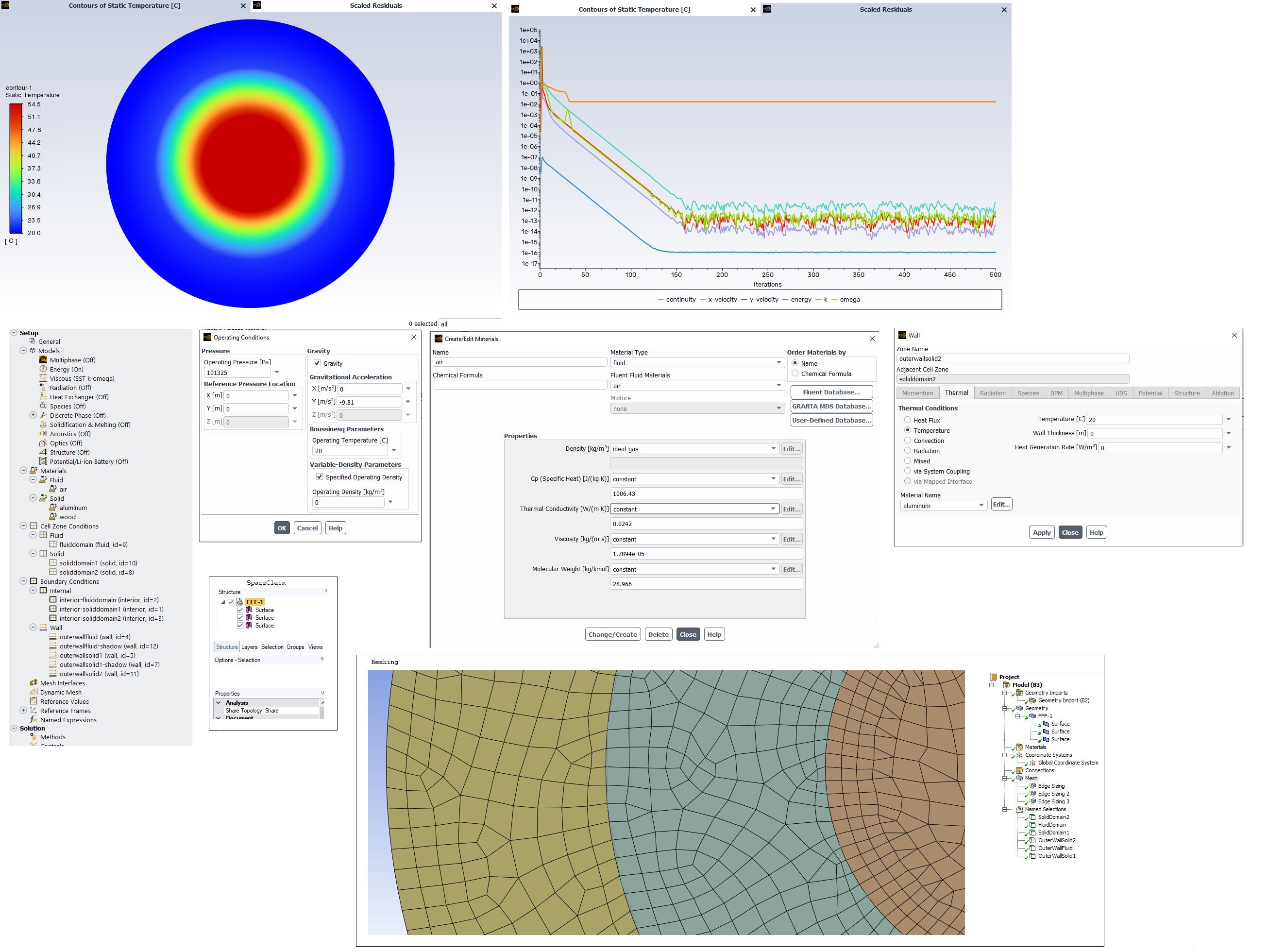

I am trying to learn how to use Ansys Fluent for steady state 2D thermal analysis. I am attempting to simulate a situation where an electrical conductor generates heat, and the conductor is surrounded by an air-filled fluid region, which in turn is enclosed by a solid material (wood). It seems that natural convection is not working in the fluid region, and the heat does not appear to transfer from the fluid to the wood. Could someone advise what might be wrong? I have managed to simulate a similar situation with only an aluminum core surrounded by air, i.e., a solid-fluid setup.Here is some details:

Forum ModeratorWhy do you need interface zones? If they're not set correctly it'll not help. Then check air density.

SubscriberInterface zones are generated automatically, I can't say if they are necessary. I believe the air density is correct since it works in the solid-fluid case that I previously managed to get working. Attached is an image of this earlier solid-fluid simulation. It is slightly larger in dimensions, but otherwise, it operates on the same principle. In that case, natural convection works, and the residuals converge. In the solid-fluid-solid situation, there is probably some boundary condition issue, but I can't pinpoint what it is.
Here is results of that solid-fluid case.
December 4, 2024 at 10:07 am
Rob
Forum ModeratorIn a sealed domain you need ideal gas. Incompressible ideal gas would be the correct choice in an open domain.
Solid-fluid nonconformals are a little special and I'd avoid when learning to use the software. Read up on share-topology.

Forum ModeratorOK. So the outer wall is fixed at 20C, but you're adding in some W/m3 to the centre solid? If you fix a flux AND the temperature what might happen? Hint: read up on what the convective wall option does.

SubscriberI do understand the situation where the outer wall temperature is fixed. The color gradient difference in the wood is not very large, but when inspected with a probe, there is a temperature difference between the inner and outer surfaces of the wood. This means that heat transfer occurs between the fluid and solid domains in that area, even though at a quick glance it may seem otherwise. The effect of natural convection initially appears not to work, but on closer inspection, the temperature above the aluminum domain is higher than below it, so natural convection works at least somehow.
What puzzles me is why the K-residual doesn't converge. Can the result still be correct even if not all residuals converge? I refined the mesh for greater accuracy, but I didn’t notice any significant difference. Could it be that the calculation model is not suitable for analyzing such a small fluid domain, or is it really the case that natural convection behaves like this in reality?
I also created a model with the same parameters but with a larger fluid domain, where natural convection behaves at least in my opinion “correctly”. In this case, the denser and lighter air masses clearly redistribute under the influence of gravity, and the K-residual also converges now.
December 9, 2024 at 11:53 am
Rob
Forum ModeratorThe lower image shows the buoyant plume nicely, assuming that's a contour of temperature. I can't read the text as it's too small.
Convergence is not just residuals. It's also monitor points (is the solution changing) and fluxes (does what goes in come out). So in this case it's very likely the residuals won't look good. You may well have a transient effect in the flow, additionally the answer may not be too far off the initial condition (for some fields) so the residual maths can't reduce the error.

SubscriberYes, the contours represent temperature, image can be enlarged by zooming in on the page. This was a hypothetical situation to get started and understand how such a case is defined, but I’ll need to look into the convergence issue more closely if it turns out to be a problem.
