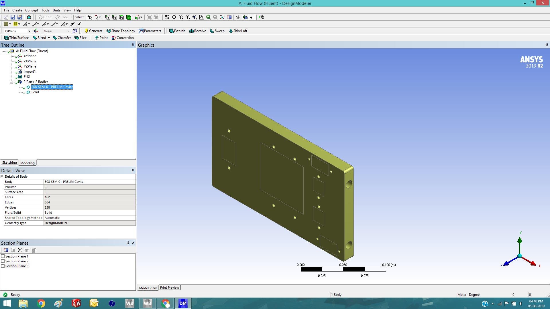

SubscriberHi everyone, Im a beginner at ANSYS workbench. I wish to obtain thermal analysis of a liquid cooling pad. Simple guidelines could help me a lot.Â
1. Defining fluid domain.
2. Defining heat flux at surface.
3. Need temperature of coolant at inlet and outlet.
Attaching files for reference.

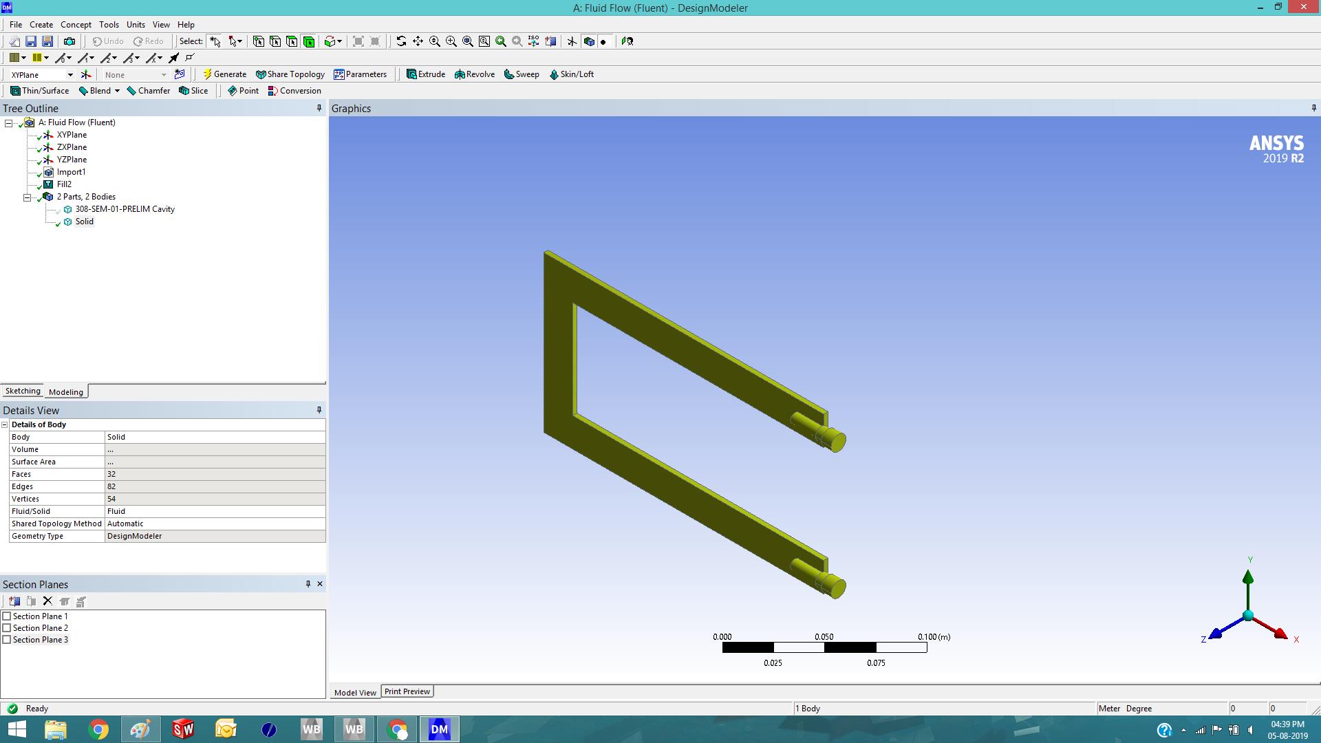

SubscriberStart Workbench, drag out a Fluid Flow (Fluent) analysis system.
Double click on Geometry cell. File, Open set type to STEP, and select your file.Â
Select the Prepare tab on the ribbon interface.
Select the Volume Extract tool, which opens ready for you to click a face that closes off the volume. Click on the annular flat face on the inlet side, then click on the annular flat face on the outlet side. Now click the Seed Face button, and click a face inside the fluid cavity. When you click the check mark, you will have the fluid volume.
Finally, click the top level in the Outline, FFF and in the Properties window, on the Share Topology line, set it to Share.
I would also delete the faces on all the holes drilled into the pad to make the solid mesh cleaner, but you can leave those in.
Close the SpaceClaim window.
Next you open Mesh and define the Inlet and Outlet faces of the fluid volume using Named Selections. Name the Heat Flux face as well. Any outer face you don't name will automatically be insulated. There are best practices for meshing fluid volumes, but let's leave that for another post. Close Meshing, then right mouse button on the Mesh cell and select Update. Wait for the Mesh cell to have a green check mark. Then you can click the Setup cell which will start Fluent.

SubscriberBeing a beginner I'm facing issues selecting the internal faces to define the cavity. I did make fluid domain in design-modeler.
Internal temperature 20 degree Celcius. Flowrate 4-5 Liter per min.

peteroznewman
SubscriberOne suggestion, Mechanical automatically created a Contact region in Meshing, which created an extra boundary condition in Fluent.
Go back to DesignModeler, and make sure the solid and fluid bodies are in a Multibody Part by using Form New Part and set that part to Share Topology.
Then go back to Meshing and delete the Contact.
Then reread it back into Fluent. It will notice a BC is missing. Follow the directions to resolve that.
What you have works, it's just more complicated that it needs to be.

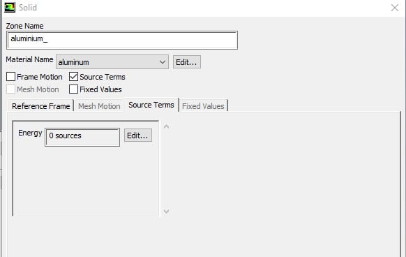

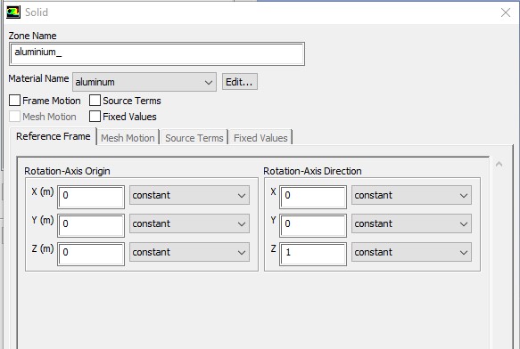

August 24, 2019 at 11:21 pm
peteroznewman
SubscriberI can only answer one of your questions because I recently learned about that. You want Coupled as the BC on the wall that is between the fluid and solid. Coupled allows the solver to automatically compute the heat transfer between the solid and the fluid. You get a wall and a shadow-wall so that you could make the heat transfer different in the solid and the fluid, but you don't need to do that.
