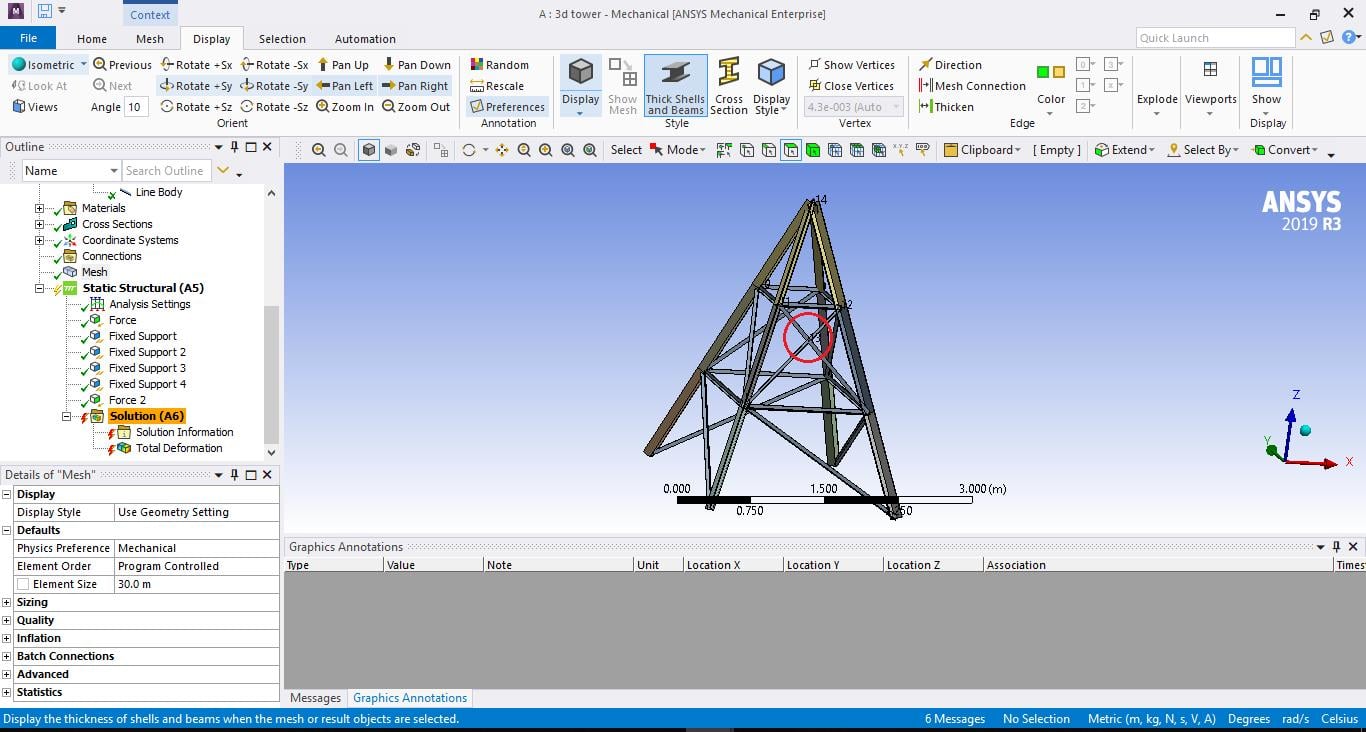

There is at least 1 small equation solver pivot term plz help!!
    • mohammed164
      *** ERROR ***                           CP =       1.469   TIME= 230:45
       There is at least 1 small equation solver pivot term (e.g., at the ROTY
       degree of freedom of node 348).  Please check for an insufficiently
       constrained model.
      Some part of the model is free to rotate about the Y axis.  Add a constraint to stop that.
    • mohammed164
      i'm sorry but how !!?
      How many parts are in this model and how are they connected to each other?  How is the model connected to ground?
    • mohammed164
      THANK YOU AGAIN
      IF you don't get upset!!

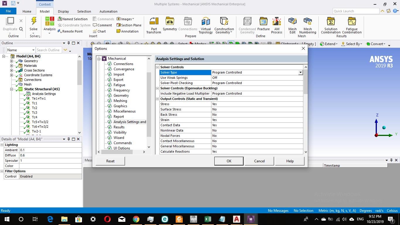

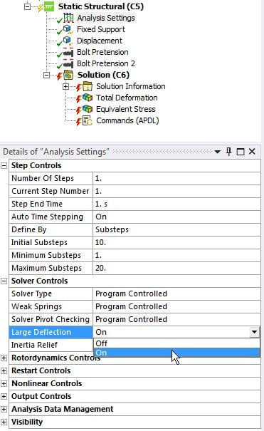

      i have anther problem when i try to exchange line body from beam to truss he told switch to large deflection but in solver control can't find large deflection option !!??
      THANK YOU
    • mohammed164
      In Mechancial, under Static Structural click on Analysis Settings.  Large Deflection is turned on there.

      THANKS AGAIN

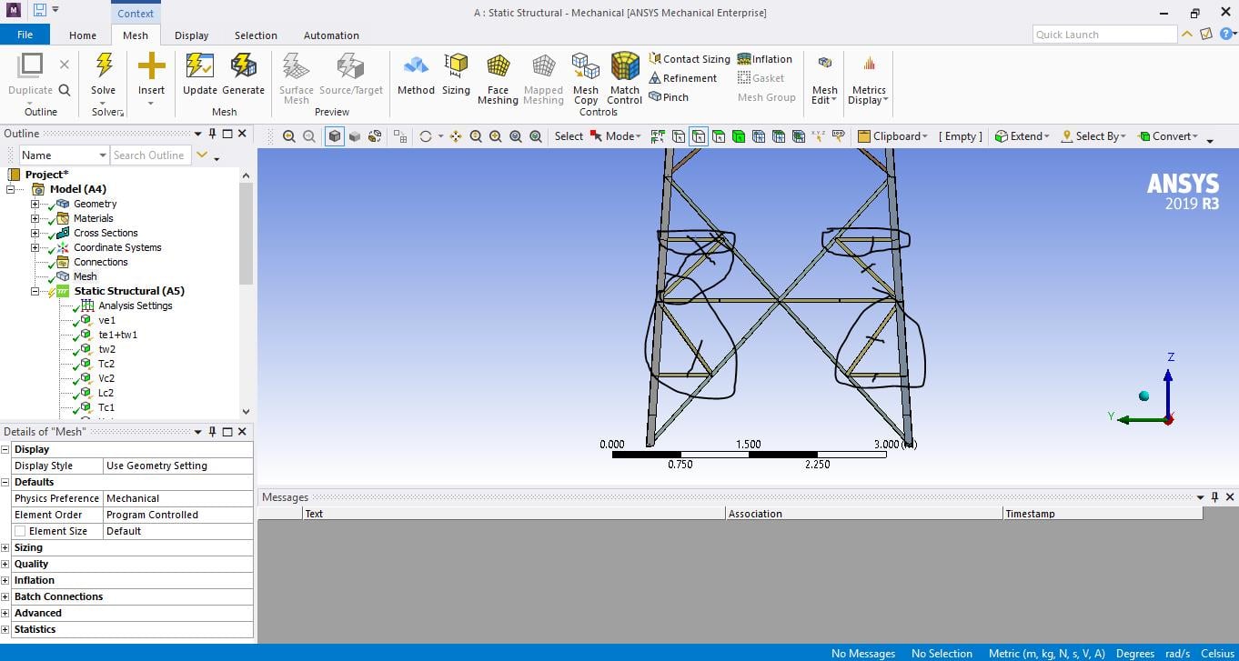

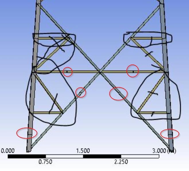

      hi
      I figure out what the problem and solved Except one element give me error
      *** ERROR ***                           CP =       1.469   TIME= 22:420
       There are 1 small equation solver pivot terms (e.g., at the UZ degree
       of freedom of node 47).  Please check for an insufficiently
       constrained model.
      i try every member and no thing !!!?
      please help !!!
      What are these lines across the section? That looks like there is a node/vertex at that point. If those are all Truss elements, that is no good.  If those are Beam elements then it is okay.
    • mohammed164
      that's what i figure out and fixed unless one member can't find

      Doing a simple model is an excellent idea.  The defect in the simple model above is a lack of diagonal members on each face of the cube. That means it is a mechanism that can collapse, not a structure.
      Do an even simpler model: three line bodies that come from a common point, the origin, 0,0,0.  Line body X is along the X-axis and the other end is 1,0,0. Line body Y is along the Y axis and the other end is 0,1,0.  Line body Z is along the Z-axis and the other end is 0,0,1.  Make sure you have only one LINK180 element on each line body. Make sure you do a Mesh Merge for the three nodes at 0,0,0 so there is only one node there. An alternative to Mesh Merge is to use Shared Topology in SpaceClaim.  Apply a force to the origin vertex.  Select the three vertices at the unit distance and make them Simply Supported. That model should solve without fail.
    • mohammed164
      i made simple model and solve without problem
      when add a member cross with anther member give me same error
      how can i solve this problem?
      Do you have four links that meet at a point in the center?  Are those four links in a plane? That creates a problem because there is zero stiffness of the center point in and out of the plane.  Don't do that, it is not a truss.
      If instead you have two diagonal links that don't connect in the center, but just pass by each other and reach corner to corner, then you have made triangular shapes that have stiffness.

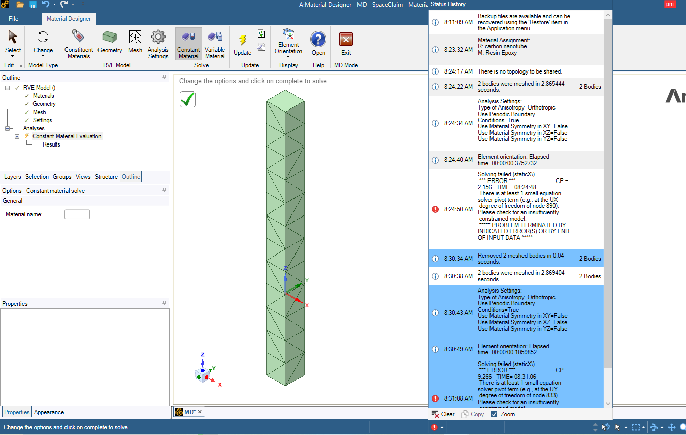

    • Haddouch Ibrahim
      Hello everyone, I face a problem when I want to compute elastic properties of nanoscale RVE using material Desing SpceCleam, the error is figured in the screen bellow
